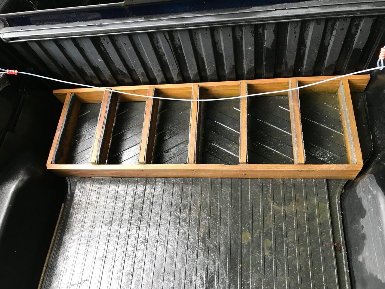

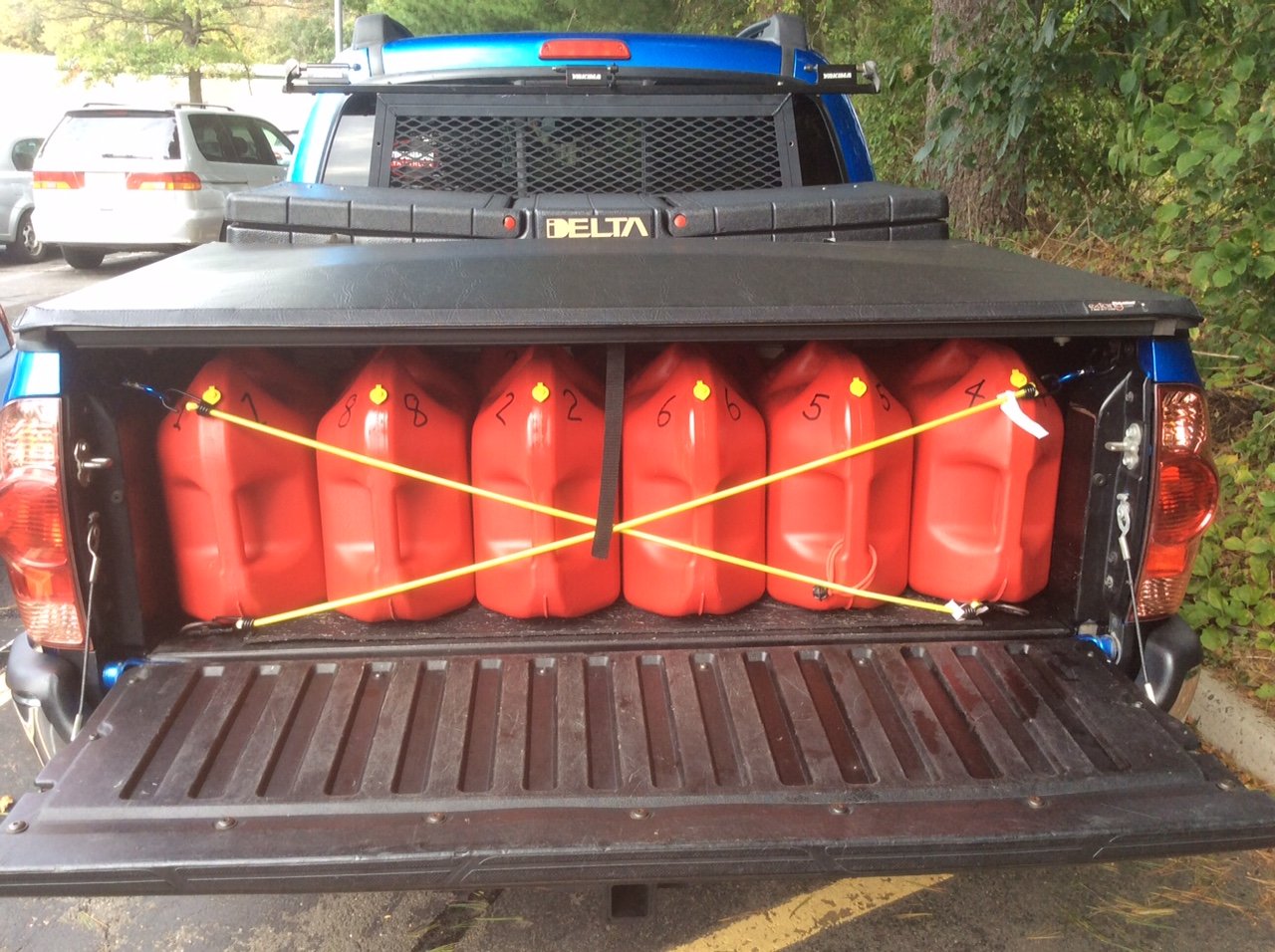

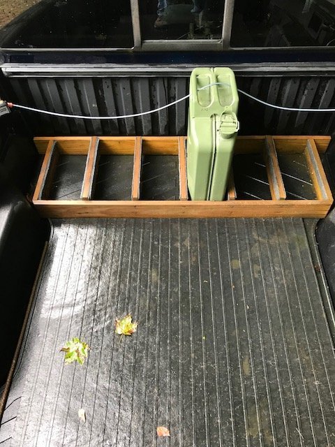

    Cans stay put, full or empty, can't tip. Fits my '06 short bed. Measure yours and build to fit. Helps if you already have a Jerry can to use as a guide.
    Make a rectangle box frame to fit between the front width of the bed, sidewall to sidewall, and the front inside corner of each wheel well, from 1X4 treated lumber. There will be a small space left over at each end. Very useful.
    Cut 5 dividers from 1X4's to fit inside the frame. These should be the same length as the frame side boards. Space them equally, making 6 Jerry can spaces. It's ok if the spaces are 1/2" wider than a can width.
    Cut the ends of the fender well frame board at a 45 degree angle so it fits, if needed. Check the photo, self explanatory. Should not be a tight fit. You'll want to be able to remove it easily. It has enough empty weight to stay in place with a slightly loose fit.
    Mock it up, make sure everything fits. Pre-drill wheel well edge screw locations 3/8" in from the edges with a drill bit slightly smaller than a screw shank (I used a finish nail as a bit) to keep the edge from splitting out. Use 1-1/4" drywall screws, two per board connection, screw it all together, keeping it square and flat.
    Hint: raise the dividers an inch above the frame. This will give each can more side support (not that it's needed) and help the bed to drain normally.
    Staple strips of 1" wide X 3/16", 1/4", 3/8" etc. thick felt weatherstriping on each side of the dividers at the top edges, for a tighter can fit, as needed.
    A simple 8' plastic coated steel cable through the handles and a weatherproof lock through a bed rail tie-down provides security. :thumbsup:

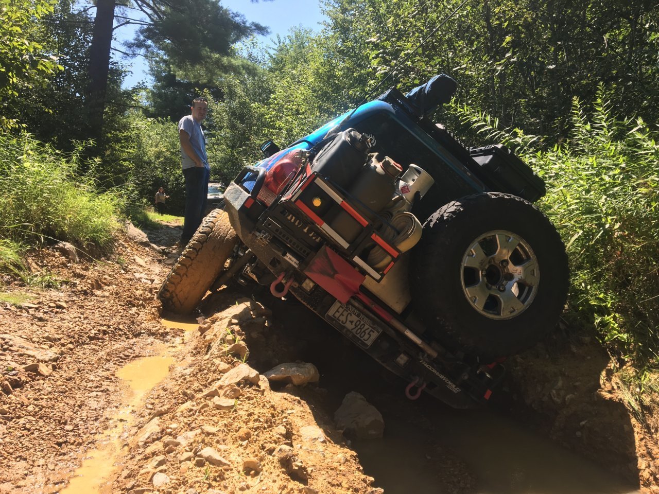

    Fill to 20L and no more. The can is designed for that quantity. When warmed, the gas will expand, but the internal air will compress to deal with the gas expansion. If you overfill, then you decrease the internal airspace that is supposed to accommodate the fuel expansion.
    There will be minimal expansion, no matter what. But not the overly bloated, balloon like swelling.
    MWC left
    MFC right
    6 lb aluminum propane tank further right (behind snatch strap)
    All loaded onto a dual and single BFF Jerry can holders attached to BFF bumper swingout.

    That looks fairly safe. It looks high and tucked in.

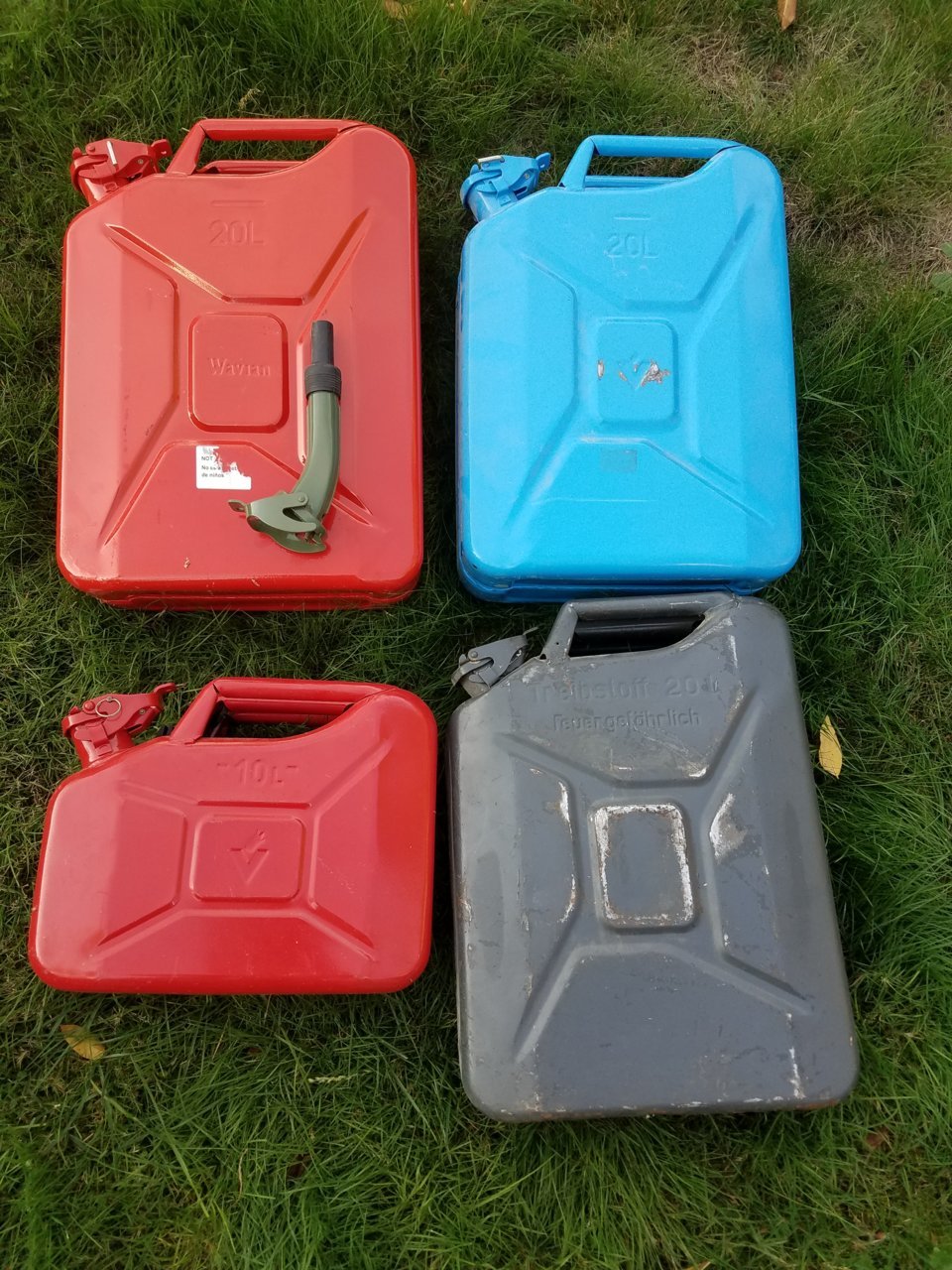

    Coming into this thread a little late but I've got a bit of experience with these cans. I have about a dozen for fuel, two for water. Don't bother with the water ones. Yes, they have a food grade interior coating, but it's not very durable and Wavian/Valpro does not recommend storing water inside of them despite the fact that they advertise them as ... a water can. Also, speaking of advertising, this style of can is technically not legal because they don't meet the CARB fuel storage requirements. This is why you frequently see things like "not for fuel storage" or "for reenactment only".
    There are differences between a "true" NATO can and the Wavian/Valpro cans. The spouts, while extremely close, are NOT interchangeable without leaks. I have two surplus NATO cans and the NATO spout and four Wavian cans with Wavian spouts and I think six Valpro cans with Valpro spouts. The Wavian and Valpro cans appear to be interchangeable. Buy the spout from whomever you buy the can from, be advised that they don't always automatically come with the can. Deutsche Optik frequently does a 4 can sale, as does British Atlantic. I haven't had a chance to pick up one of the SS cans. I really want one, but not badly enough to shell out $200 for one.
    The 20L can is usually the one everyone goes with but keep in mind that there's also a 10L available that is the same footprint but half the height. My wife prefers the 10L as it's lighter and easier to manage. There's a smaller 5L available, but IMO they're almost too small to be useful.
    FWIW, clockwise from upper left, Wavian 20L gas, Valpro 20L water, NATO 20L whatever (it has ID tags that you can change to display what fuel is inside) and Valpro 10L gas.
    The spout is the stubby Valpro that also fits Wavian.

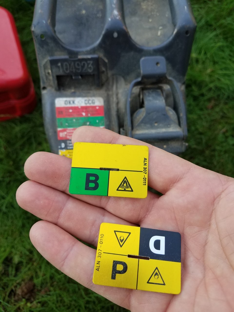

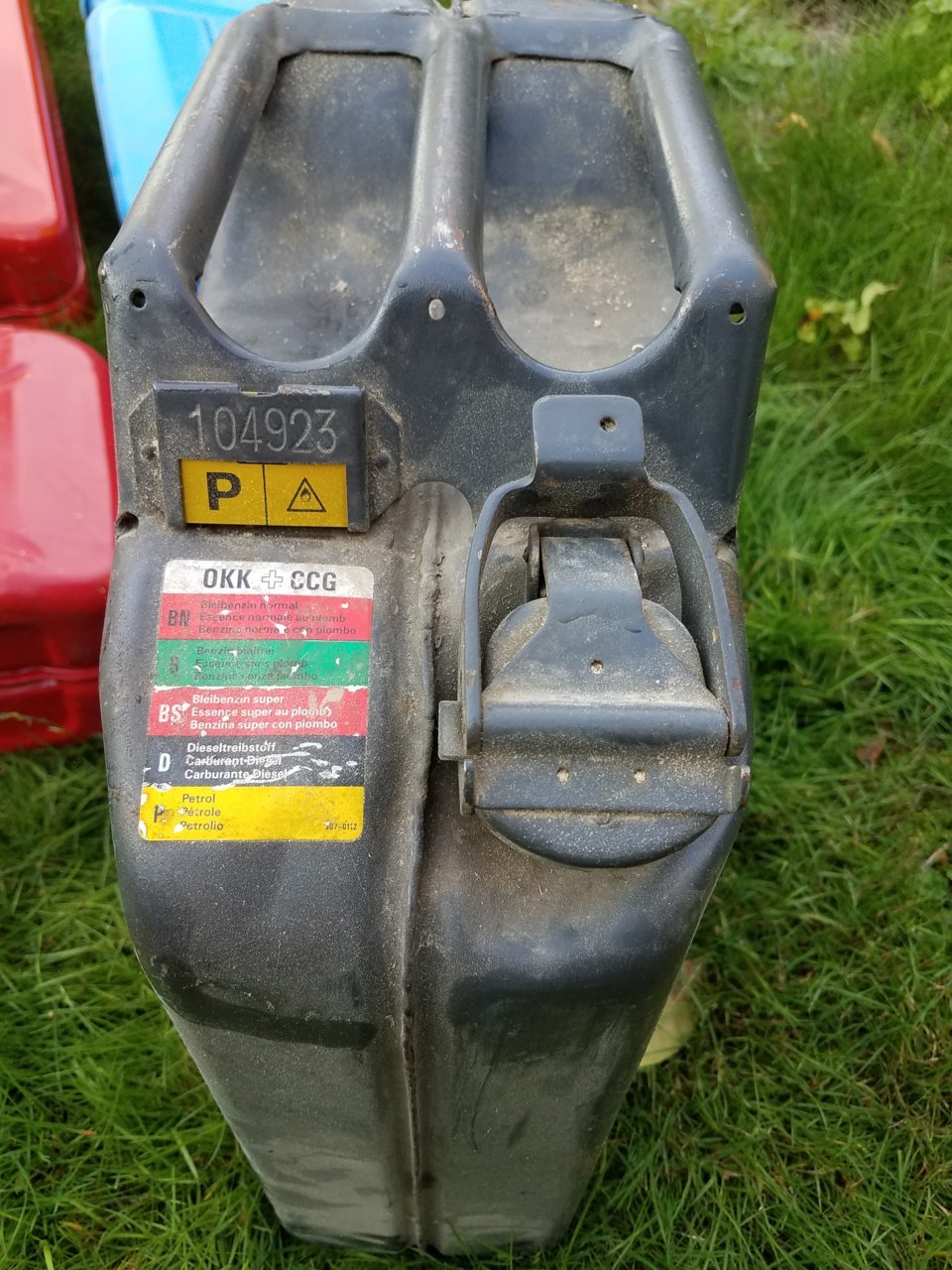

    Since I mentioned them, here's pictures of the NATO ID tags and their bracket.

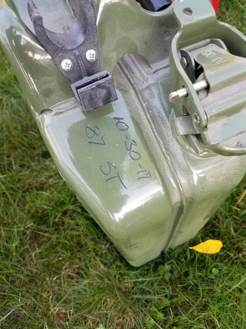

    Also, one other thing I recommend is tossing a China marker in your glove box and labeling what and when you filled the can, for example:
    This can was filled Oct 30, 2017 with 87 octane and dosed with fuel stabilizer. It's the next can going into my truck. I cycle through my storage cans when my truck hits 1/4 tank. I put in one can, top up the tank at the gas station and refill the can. I add the stabilizer to the can after I empty it.
