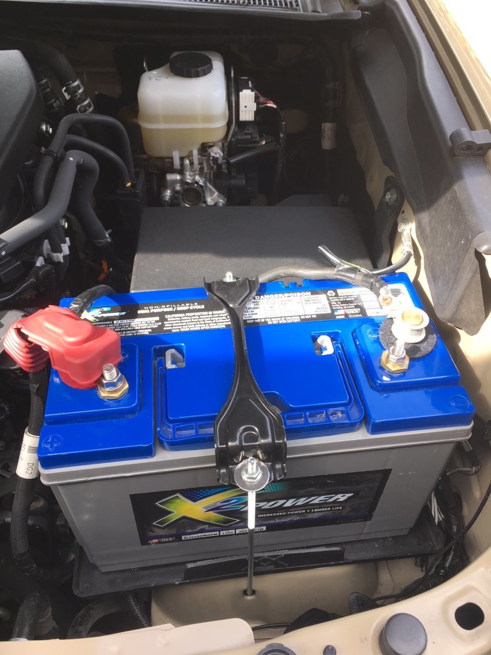

    I bought a 2nd hand Northstar 31 it’s manufacturing date is 5 years old now and still kicking hard.

    That is a powerful mother! Just wish it was a little lighter. 15lbs heavier than the Optima but certainly a contender.

    Oh for sure had to use a step ladder to get it in and the frontend dropped about 1/4in.
