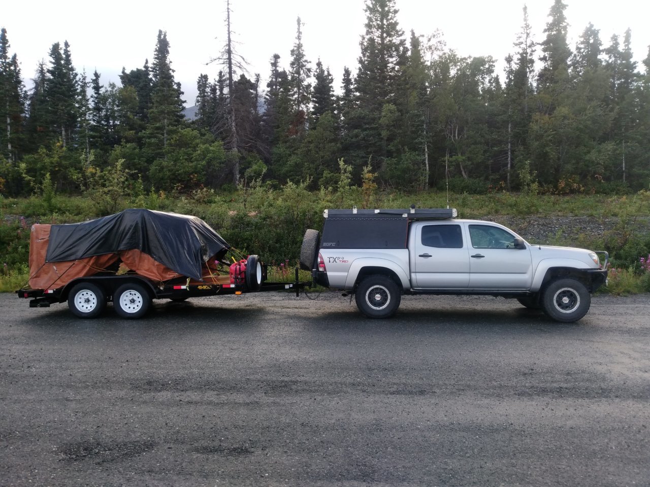

    You can upgrade the suspension and it will handle the weight fine. Technically legal - not really, but you'll still be well within the margins of safety. If removing the topper is an option you'll free up some weight as well.
    A larger truck will haul your stuff easier, tow the trailer better and get better gas mileage doing it. You mentioned the $4k added cost in taxes but you're considering spending $1000ish on new tires, $1000ish in rear suspension, $2000ish in gears, and more for tune, cooler, etc. By the time you're done you'd have paid the difference that would've put you in a new truck designed for that you want to do.

    You can do it and the truck won't explode, it just won't be within legal limits. In this picture my truck weighed 6480lbs without me and my dog in it, so about 6700lbs total. That's not including the hitch weight of the trailer with the jeep on it that I didn't weigh but was roughly 3500lbs probably. I drove that from AK to WA without a single problem.
    A larger truck would've been easier and probably a little safer but after I dropped the trailer off I then went and drove the trans america trail from the Pacific to Colorado which would've been much harder in the bigger truck.

    Sweet setup and thanks for sharing! I appreciate the insight. It’s tough when I want my truck to do everything and be everything.
