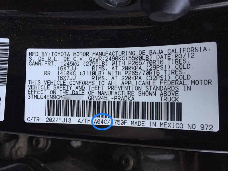

    TnShooter
    TnShooter The TacomaWorld Stray
    Sep 2, 2010
    #42625
    20,865
    Deogee
    07' TRD Off-Road, Auto
    STOCK
    asuchemist and Biscuits like this.
  16. Nov 20, 2021 at 7:01 PM
    #16
    hotajax
    hotajax [OP] Well-Known Member
    Oct 3, 2019
    #306993
    64
    09 TRD Off Road
    Tru Shooter: That's some good info. Thanks.
    Biscuits and TnShooter[QUOTED] like this.
  17. Nov 20, 2021 at 7:12 PM
    #17
    TnShooter
    Sep 2, 2010
    #42625
    20,865
    Deogee
    STOCK
    Don’t be surprised if your code reads “C”.
    Which is limited slip. But I’m pretty 2009+ trucks went to Auto-LSD.
    Which is technically an open rear, but used the brakes to simulate a mechanical LSD.
    @nd4spdbh will probably know.
    Biscuits likes this.
  18. Nov 20, 2021 at 7:28 PM
    #18
    hotajax
    Oct 3, 2019
    #306993
    64
    09 TRD Off Road
    Is the C in the first position of that 4-digit code?
  19. Nov 20, 2021 at 7:59 PM
    #19
    TnShooter
    Sep 2, 2010
    #42625
    20,865
    Deogee
    STOCK
    It would be the last digit (4th)
    1 digit is Ring Gear size
    2 & 3 digit is Ratio
    4. Is type (open, locker, or lsd)
  20. Nov 20, 2021 at 8:05 PM
    #20
    hotajax
    Oct 3, 2019
    #306993
    64
    09 TRD Off Road
    That's good info. Thank you.
