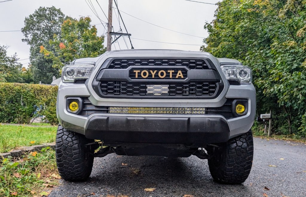

    Why not go with a 30" light bar in between the bumper cover and grille. It is stealthy and will give you more light

    I put a Rigid behind the bumper portion of the grill. Right now it's connected to a switch in an empty slot to the left of the steering wheel and can be turned on whenever the truck is on but I'm planning on changing it so the switch will get power only when the high beams are on. That way I can use the high beams as normal but add the light bar when I'm out in the rural areas upstate and have it operate with the high beam switch. You can grab high beam power at the high beam fuse in the fuse box under the hood. Of course from the switch it then goes to a relay to power the light bar. When I turn that thing on it really is impressive how much light it throws.
