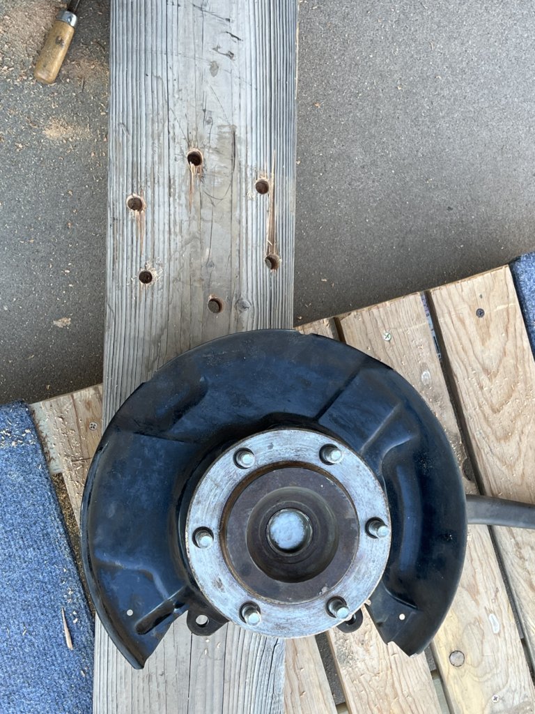

    I am new to forum as well. I bought my Tacoma Prerunner new in 1998 and do all the maintenance myself after being burned by a local dealership here in Tempe, AZ. My truck has 349.8 k on original engine; I just changed timing belt 3rd time over the blazing summer. I run Michelin’s since wearing out the first set of Goodrich’s. About 150k ago I took truck to a local off road suspension shop to change LCAs. They installed after-market moog LCAs because inside of tires were wearing faster (I kept the used/original OEM LCA in my garage). I also changed the struts at that time too. Another couple sets of tires and bam…both tires wearing on inside again. Thus because of the high mileage and not wanting to repeat the same advice taken before, I too am doing a full suspension front end rebuild: RnR UCAs, the Original LCAs with new bushings, UBJs, LBJs, struts, front wheel bearings, steering tie-rods, stabilizer bar grommets/rubber. Ive purchased OEM parts on every thing and was able to buy all parts at the “on-line” price which is 25% less the walk-in price at my favorite dealer in Mesa Az. I have already pressed the new OEM LCA bushings on my original LCAs. I used a fine-thread 3/4” hardened all-thread; a receiving cup my brother designed and machined on his lathe, another cup with OD cut-outs for relief for the bushing nubs on the other side also designed and built by my brother, 3/4” washers and nuts). The OEM bushings have two nubs that are in alignment with the two welded half’s of the LCA and the other bushing has one nub that is in 90 degrees out). I don’t know why they were installed like this…just something to keep in mind when you press yours in (take plenty of pics). I’ve tried to attached pics but app doesn’t allow…perhaps after I post I can do.
    Anyway I’m currently trying to remove my front wheel bearings. Ordered a tool on Amazon that I was able to get from reading a thread on this forum. I plan to use an air chisel with my buddy Willian to remove the old front axle locking nut then use the new tool to torque to 203ft-lbs on a new axle locking nut (after pressing in the new bearing). Does anyone else have a better method for removing the Toyota Tacoma v6 Prerunner front axle locking nut?

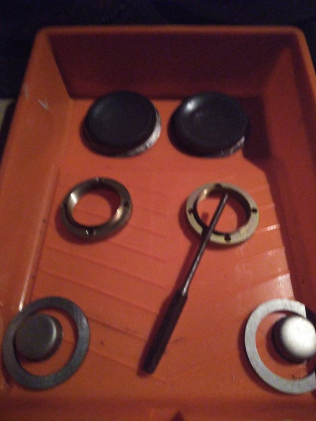

    Here is what I used, a punch and a ball peen hammer. I had to smack em pretty hard but they loosened up and spun right out. Not saying this would work for you but it did for me. I didn't wanna wait for the tool. Proper tools are always a good thing.
    I did have the knuckle out of the truck and I used some clamps to hold it to the work bench. I did use new nuts, cause they are stake nuts. I could have reused the old ones if I wanted to.

    Thanks for all of the advice. Ended up using and a pneumatic impact chisel to remove axle locking nut, It took it off in less than 1 min…worked really well. For the new axle locking nut used the OEM tool where I used a 3 ft pipe (part of my clothes line…heee) as an extension to torque to 203 ft-lb mounting spindle on 2 x6 (imprinted patten into wood, then drilled bolt hole patten in the wood) used clamps to mount to bench which also worked well. IMG_9439.png IMG_9324.jpg
