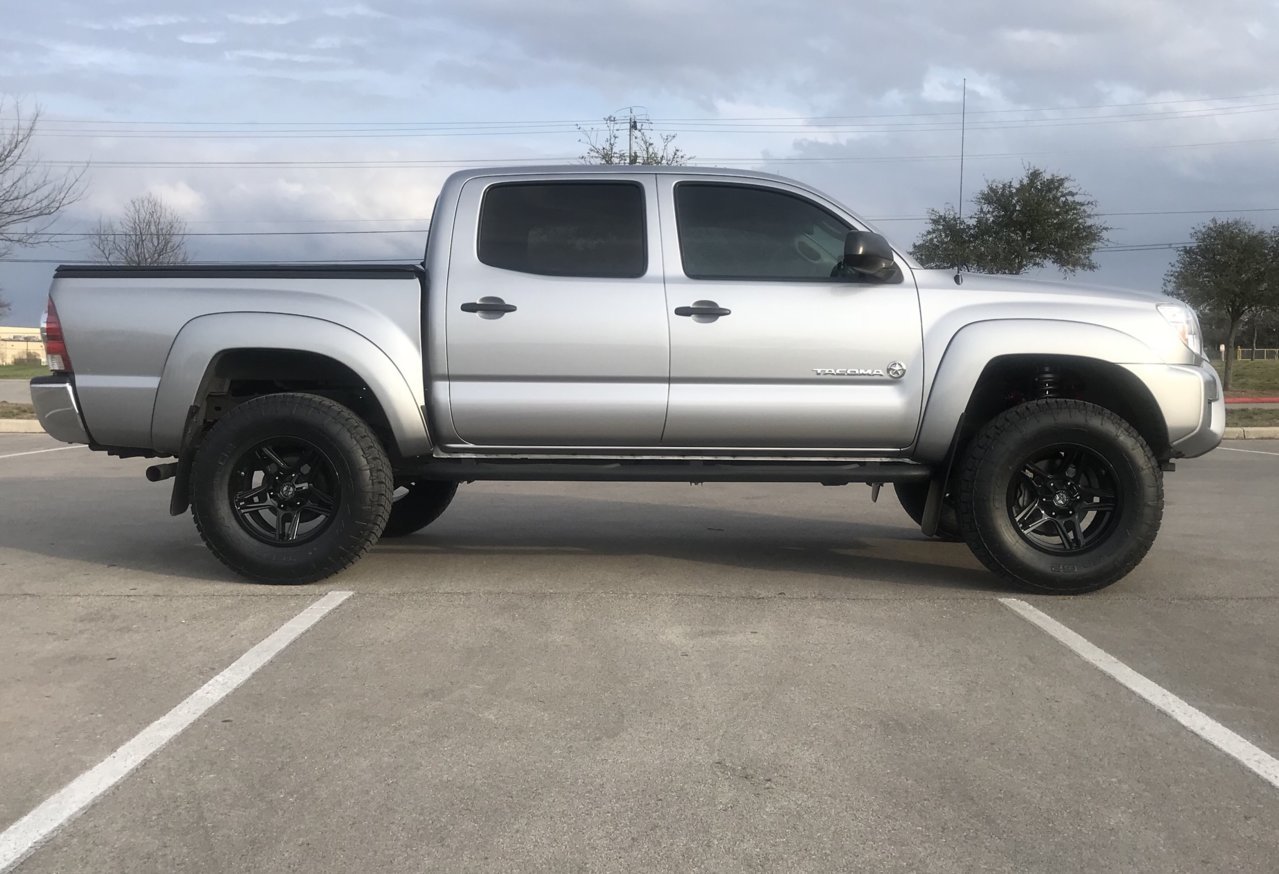

    2015 Silver Tacoma PreRunner
    3" ToyTec coilovers, JBA UCA's, Bilstein 5100's
    I’ll have a 2015. 3” Toytec coilovers, jba ucas, 17x8.5 -10 offset 285/70/17 Nittos. Just had to remove the mud flaps. Didn’t trim anything. No cab mount chop. Caster is set at 4*. 8F61ABD2-4CEF-48AE-9B5D-7B0B70E2F889.jpg
