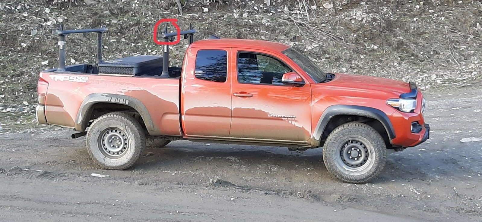

    One other thing I do for suspension noises, is to crazy rock the truck by hand so it is just bouncing up and down. That is how I found my last broken swaybar link.
    However, if you have nothing to hold onto while doing this ot can be tricky to get it moving.
    In my case it is simple as I just grab the top of my center roof rack and start bouncing it up and down.
    Had my wife do that last time while I am watching under the truck, and clickety clackety another swaybar link gone. That is 2 in the last 8 months. Truck gets beat on while off road. Not driven hard, just too many trips on shit washboard and pothole roads.
    I just grab that red circled spot and start rocking it like a son of a B. If the noise is not reproduced, it at least provides good entertainment for the neighbours. Starts to look like its on a trampoline.

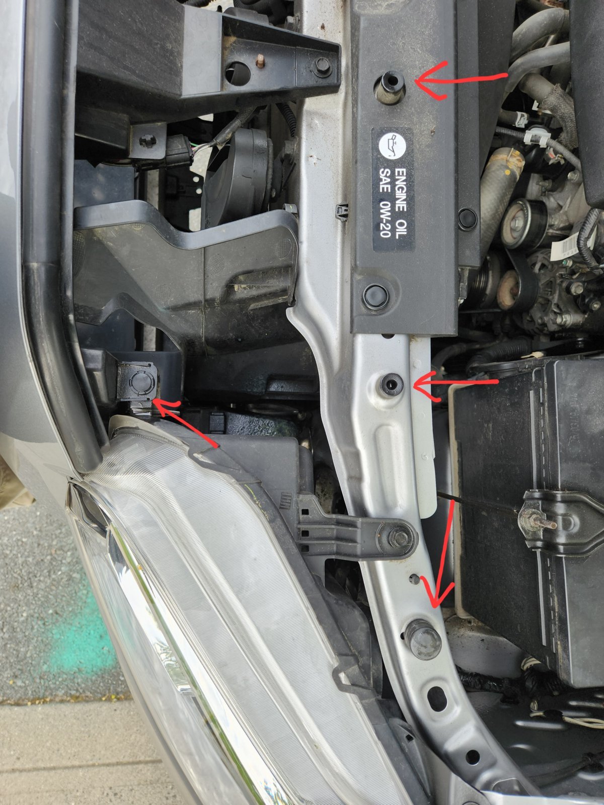

    You've got to be kidding me. I just hit these spots (and the other 4 of the same on the passenger side) with silicone spray and it was dead silent on the same road that was making noise the whole way down a half an hour ago.

    Squeaky hood eh?

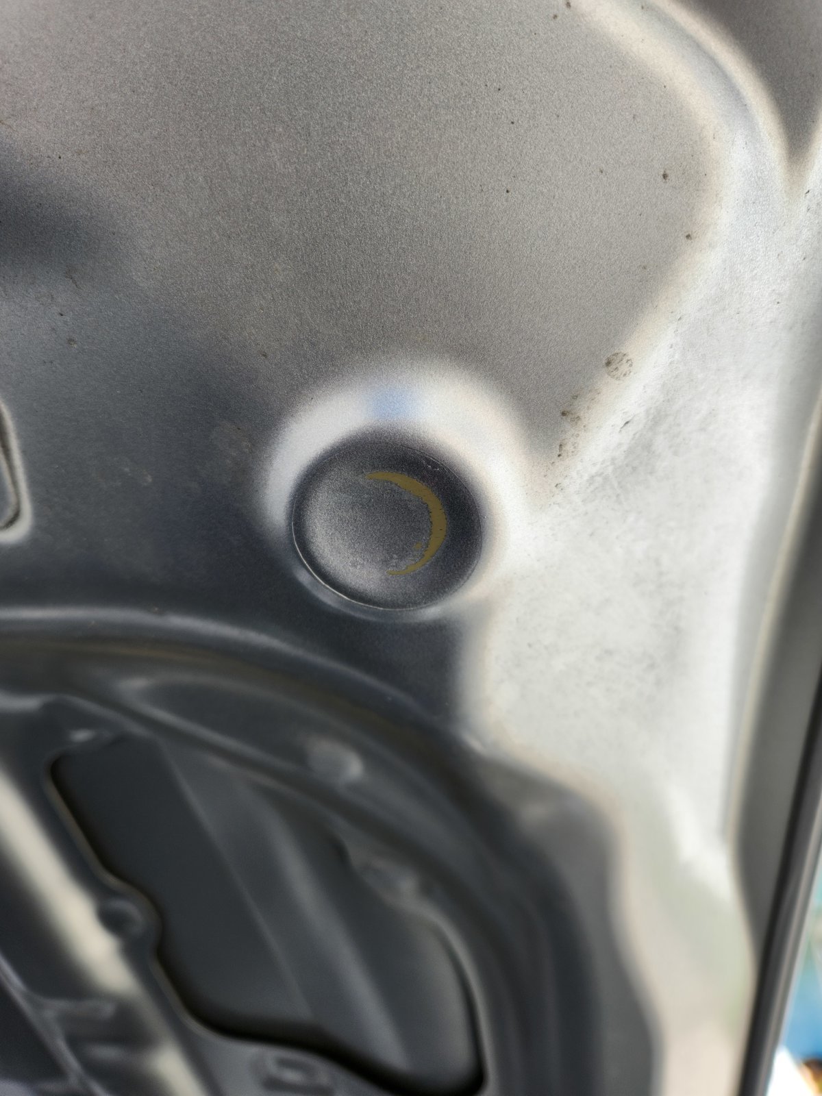

    The little pieces of film that are stuck to the hood where the rubber rests were wrecked, slid off to one side by the rubber and you can see where the paint wore through. I pulled them off, cleaned it up, and stuck on some new circles of some 3m ppf I had laying around. Hoping this cures it for a long time.
