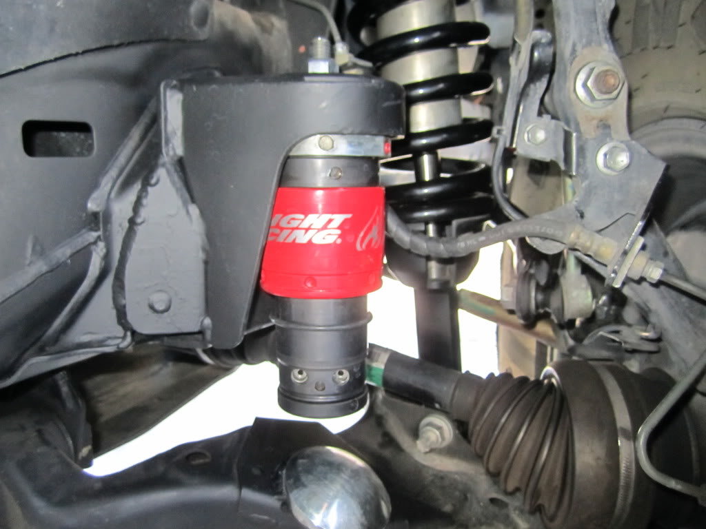

    i think your coils are fine, bumpstops are your priority - you could have somone fab you one like in this photo

    Cost effective? Get the slightly stiffer OME 880 coils I linked. Remember to run them with the Bilsteins set at the lowest position (0" lift). I see the Tuff Country kit doesn't come with bump stop extensions ( http://www.tuffcountry.com/wp-content/uploads/instructions/54900.pdf ). Nor does the competing Fabtech 6" kit (http://www.fabtechmotorsports.com/files/FT26000i.pdf ). In my opinion, trying to fabricate something will be too much work.
