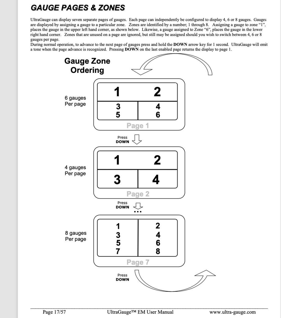

    @Skydvrr Here is a screen shot from the owners manual. You have a number of options when setting up the gauges you want to see on each page. Seven different pages with 4, 6, or 8 gauges on each page.

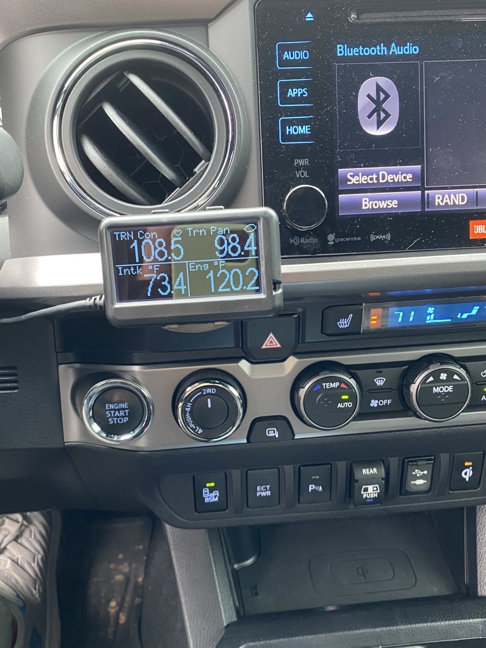

    I used a little delrin wedge, Velcro and a piece of double stick tape.
