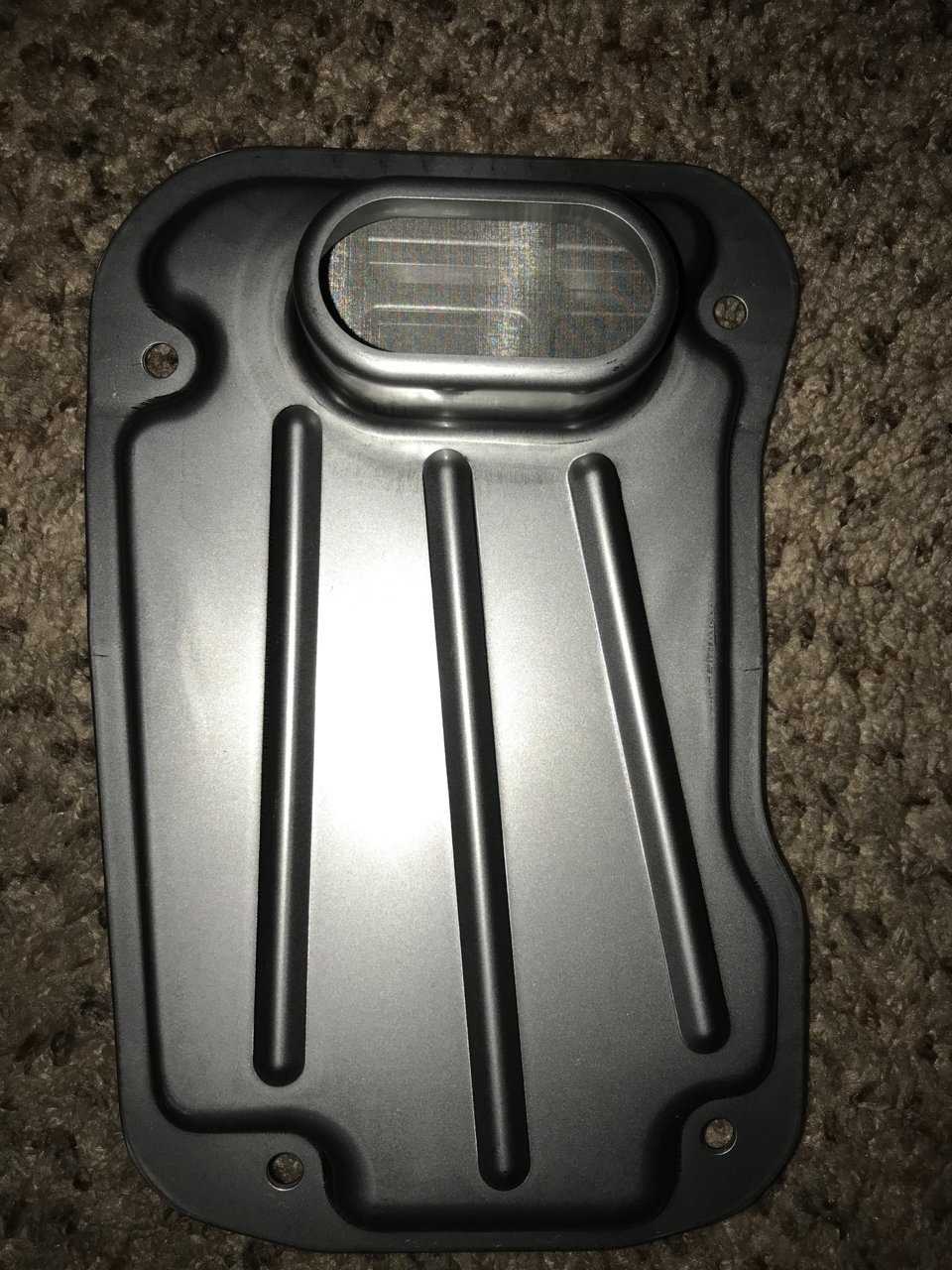

    Does this trans use a filter or a screen? almost all the info,I can find is just diy and they just drain and fill the trans.

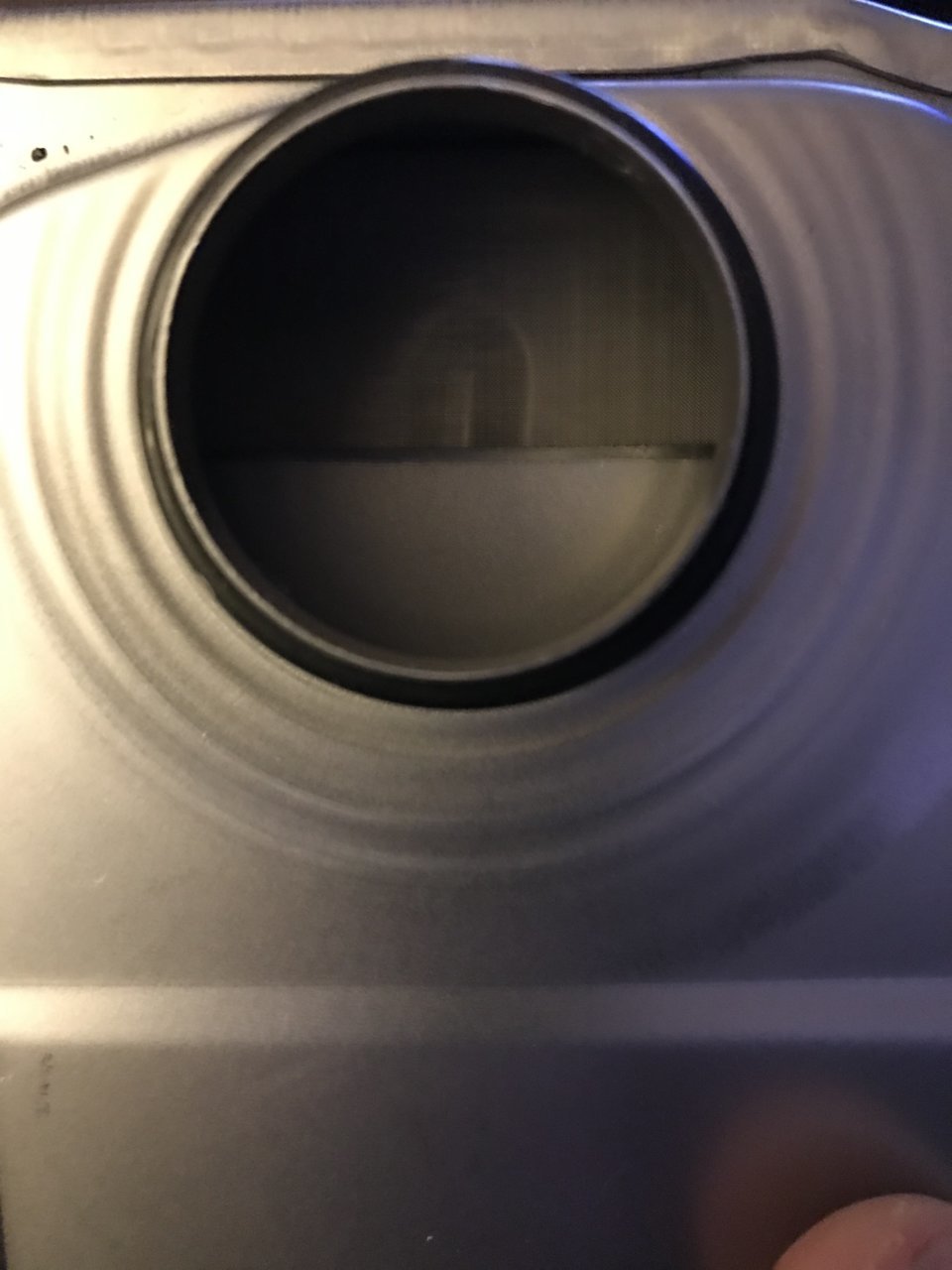

    It’s a screen type, held on by four bolts.
    01055295-1AB4-45D2-85DA-221284D16312.jpg 6514C1EB-EDDF-41F3-A30B-A66329325827.jpg 58DEACA4-7D41-4DEB-98A4-CFA3844110C1.jpg

    it has a screen, just drain and refill

    Thank you for the pics I’m just gona drain and refill
