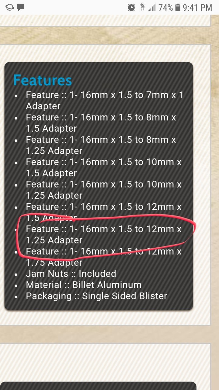

    The thread size for our stock shifter knob is M12 x 1.25

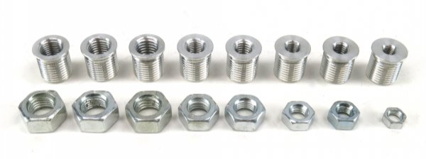

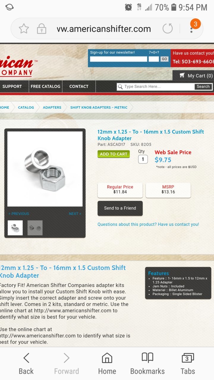

    Actually, having external threads and a nut is a good thing, I think. If I got a bolt that fits the ID I could use gotoman's idea of tapping the knob, add a little epoxy into the hole and then use the nut and bolt to drive the insert into the knob. Should be a really good bond. Just gotta watch out I don't get epoxy into the interior threads or glue the bolt into the insert.
    At $10 for the insert I'm beginning to understand why I've seen shifter knobs for sale in the ~$100 range. Parts + time is going to add up real quick.
    Thanks mtip! My searches were not yielding the best results. What keywords did you use?

    However, I have a couple ideas to try once I have time. I plan to turn the whole thing on a lathe as one piece and drill the right size hole for the threaded insert which I'll epoxy in place at the end. Drilling holes is quite easy on a lathe so my original question was where to get the right insert. Although your idea of using a nut instead of an insert would likely save $, those darn inserts ain't cheap.

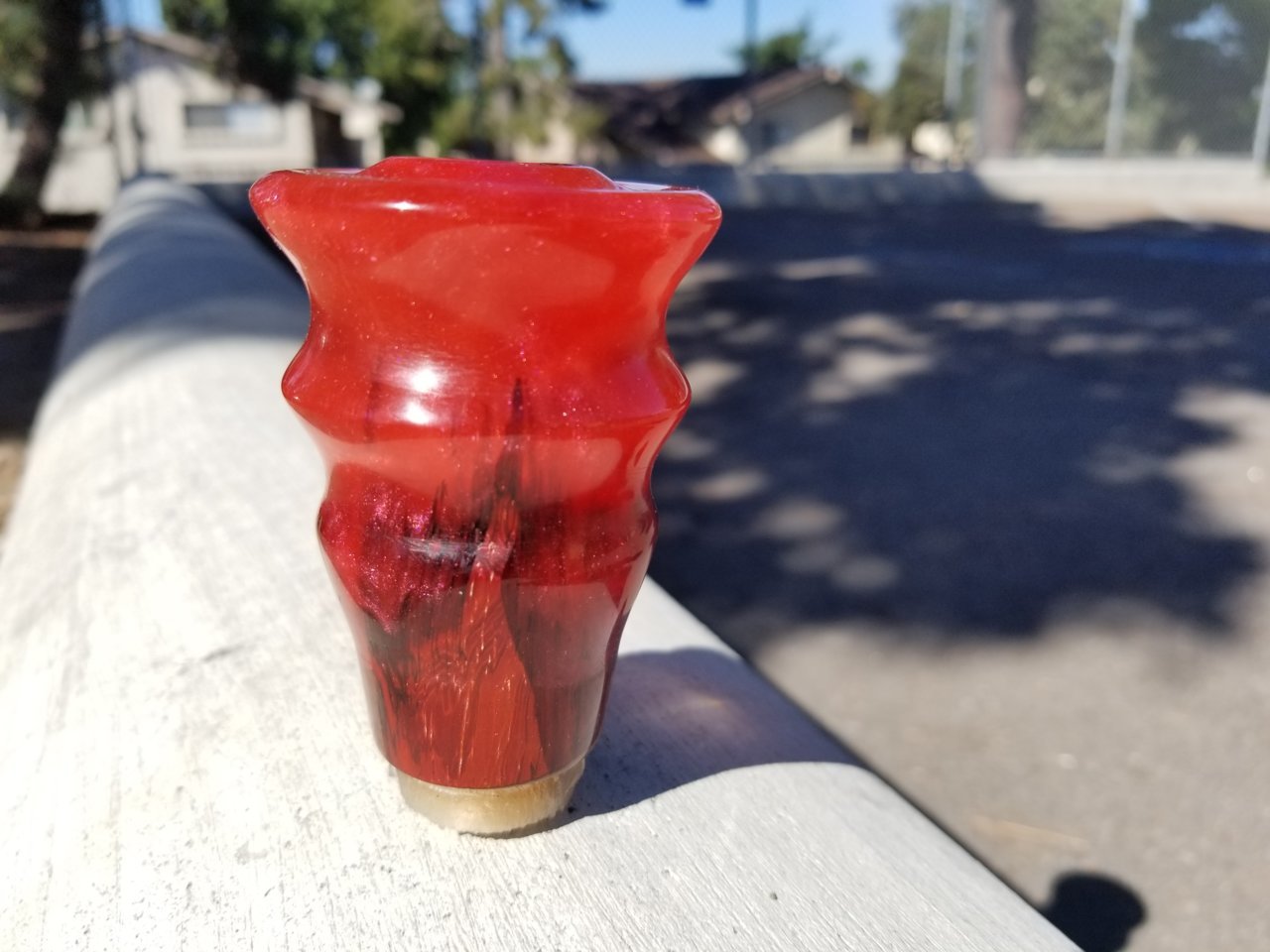

    Finally, I had time to try this out. It didn't come out exactly as I had envisioned but not bad for a first effort.
