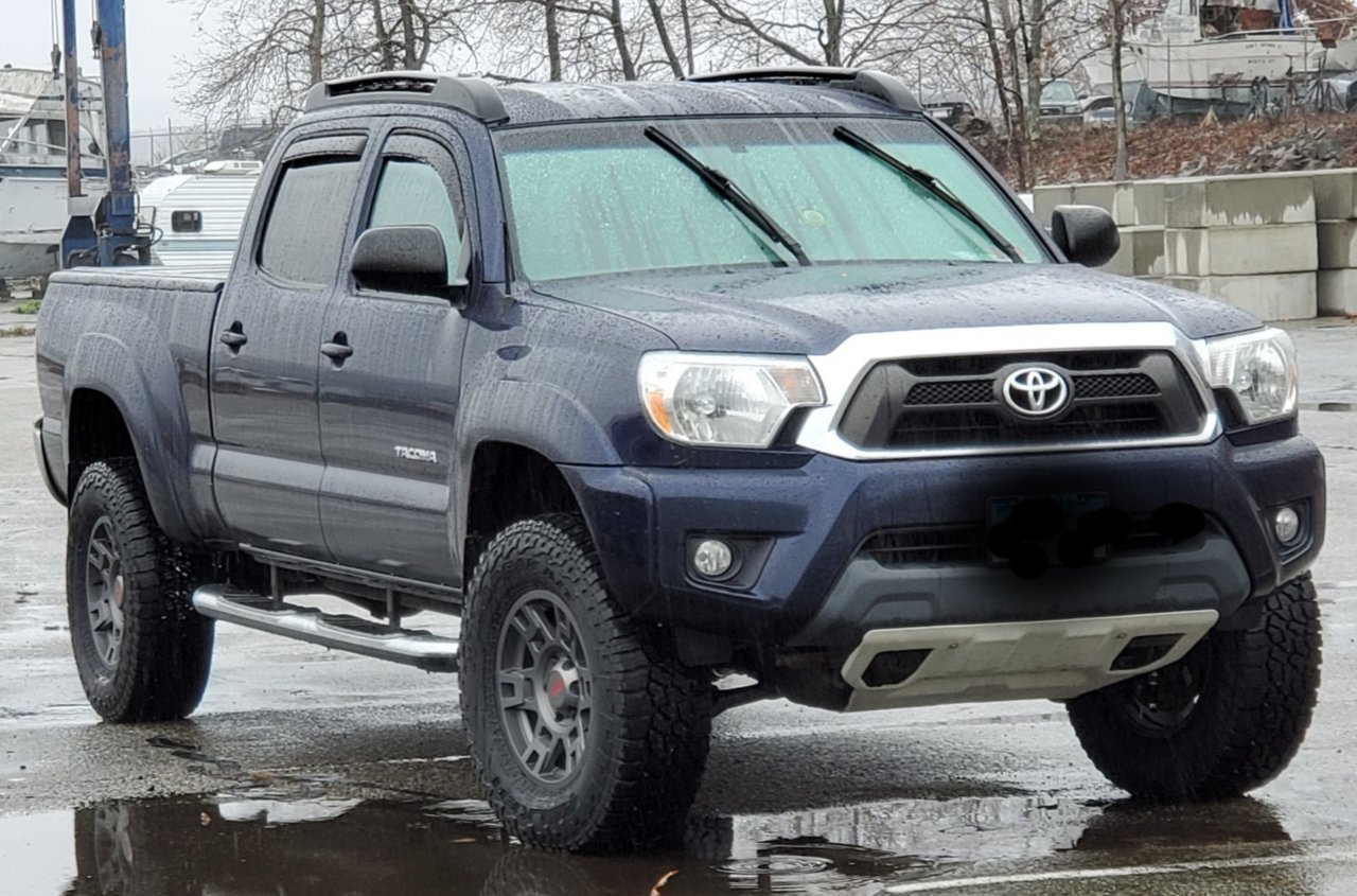

    It's in the shop. Can anyone point me in the right direction as far as any alignment specs I would specifically want?
  9. Nov 13, 2020 at 2:13 PM
    Dizzzy4130
    Dizzzy4130 [OP] Member
    Mar 13, 2015
    #150790
    20
    CT
    13 SR5 DCLB
    She looks and drives just like I was hoping for!

    Looks great. Curious why you went with the Fox 2.0s instead of the 5160s? Performance advantage or no 5160s in stock?
