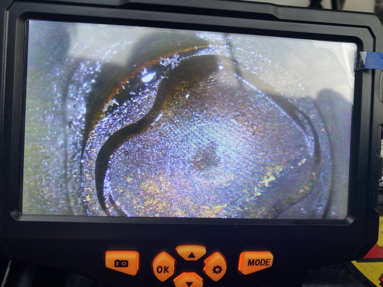

    So I found out what my issue is. Not good. My gut feeling was right I think.

    Well congrats....now your in too deep.....
    ...so I guess you get a new(ish) engine.
    Place an add here....or FB market place.....might luck out and find a crated one...
    There was a new 2rz crated short block on FB in my area 6 months ago.....
    3rz's are the most plentiful, but the 5vz's are a close second....
    3rz are head gasket eaters....and the 5vz's are crack heads.....
    I had no ideal how bad things can be.....this video shocked the shit out of me....
    check out 13:25......
    (31) Engine Head Gasket / Cracked Head Repair (Toyota 3.4L V6 5VZ-FE ) - Part 4 - YouTube

    I was watching that the other day. Not any good! In 2016 I changed my spark plugs for the first time and noticed there was a heli coil in one of the holes. Look what I found lol I put new plugs in and the plug electrode broke off and I cleaned it out. Ran it until not long ago (new plugs) and going up a hill and number 3 spark plug blew out and also lost a bunch of the plug somewhere. Probably in the combustion chamber. I am thinking the debri from that probably did it in. It does feel like it's running on 5 cylinders at the moment but doesn't run too bad surprisingly.
    Not sure what I want to do. Cut my losses and get something else? It's kind of nice not having any payment of course but I am looking at 4k to 6k for a good transplant. Could find a used lower mileage engine but that's a gamble. I have no interest in the JDM nightmare BS.
    Now - what to do... Wanted add is going up now as that' s a good idea. See what I can find!

    what's amazing is how well it still runs. Minus the miss it has developed which I am assuming is from the plug and spark getting wet from the oil. It's also kind of hard to tell what's going on in there from the oil. I think I can see the top of a piston ring. Not sure really.

    You know back in the day, I drove an engine for almost 2 years like that..
    I used the barr's 3 or 4 times until the milkshake action showed up...
    However that destroyed the radiator, I did have the foresight to by-pass the heater core.....
    Bought me some time till I lined up a plan.
