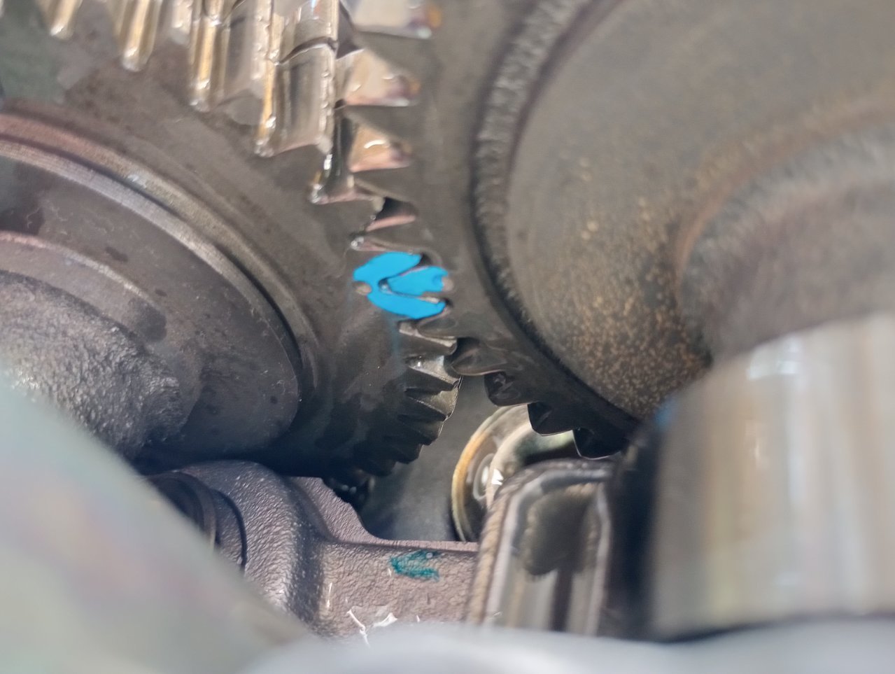

    1998 Tacoma X-Cab SR 5 2.4L L4 SOHC 16V
    I'm ignorant- what are we look'n at?

    1,690
    Jerad
    2003 Tacoma Xtra Cab 4WD
    Oil in the cylinder on top of the piston, and quite a bit of it. He mentioned his spark plug threads being replaced by a helicoil for that cylinder, but it looks like he may also have piston or or piston ring damage, based upon the oil pooling along the edge there.

    Toytec coilovers. Height adjustable Bilstein's. 265/75/16 MT. TRD wheels. Rebuilt r150f. Marlin clutch kit. All kinds of new parts...
    Yep. Combination of bad rings and from what I can see the top of the piston itself has some melting damage from what I assume were parts of the spark plug. Damn thing made many a trip with this probably. My remanned engine from Sunwest is on the freight truck now.

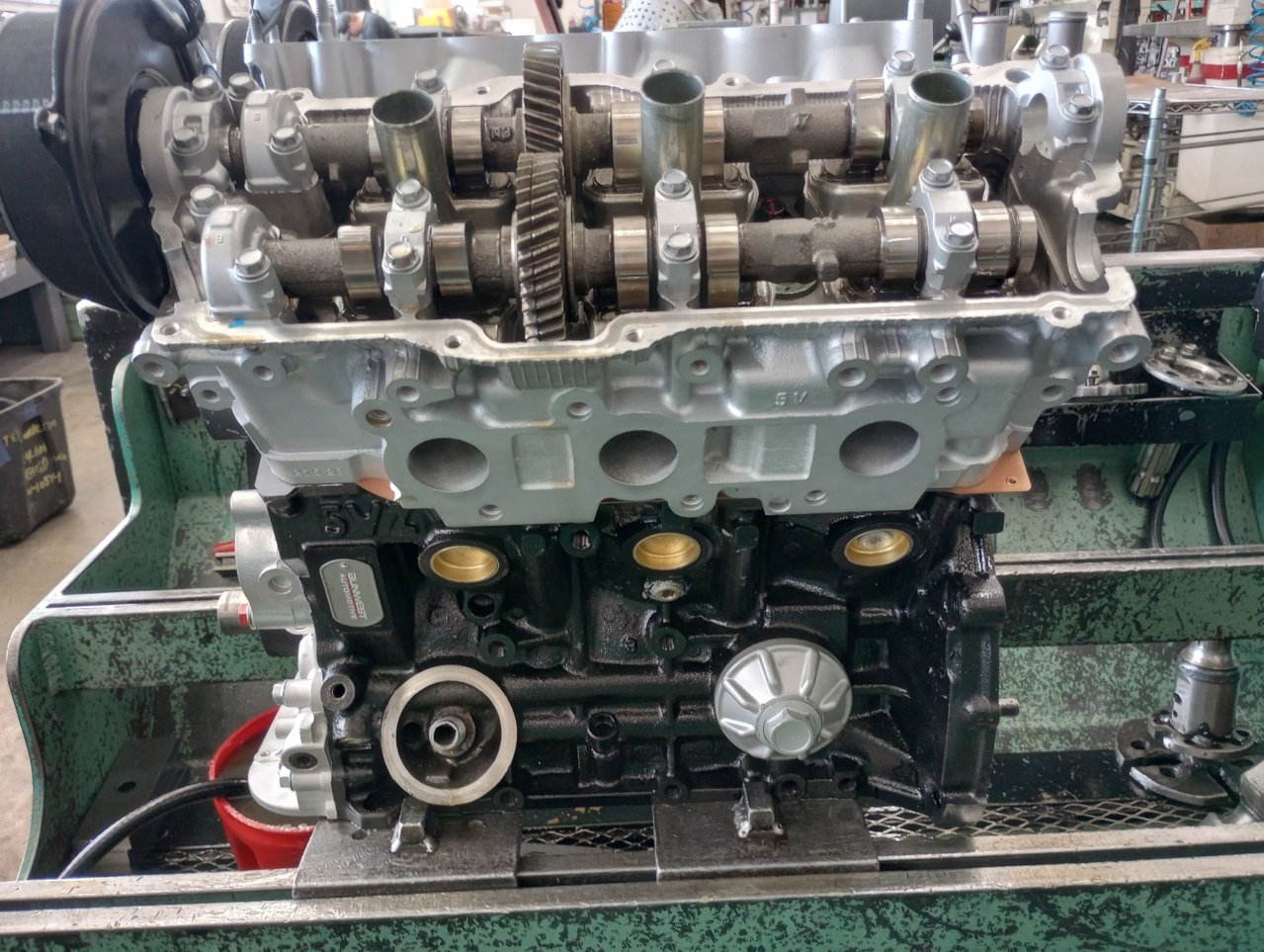

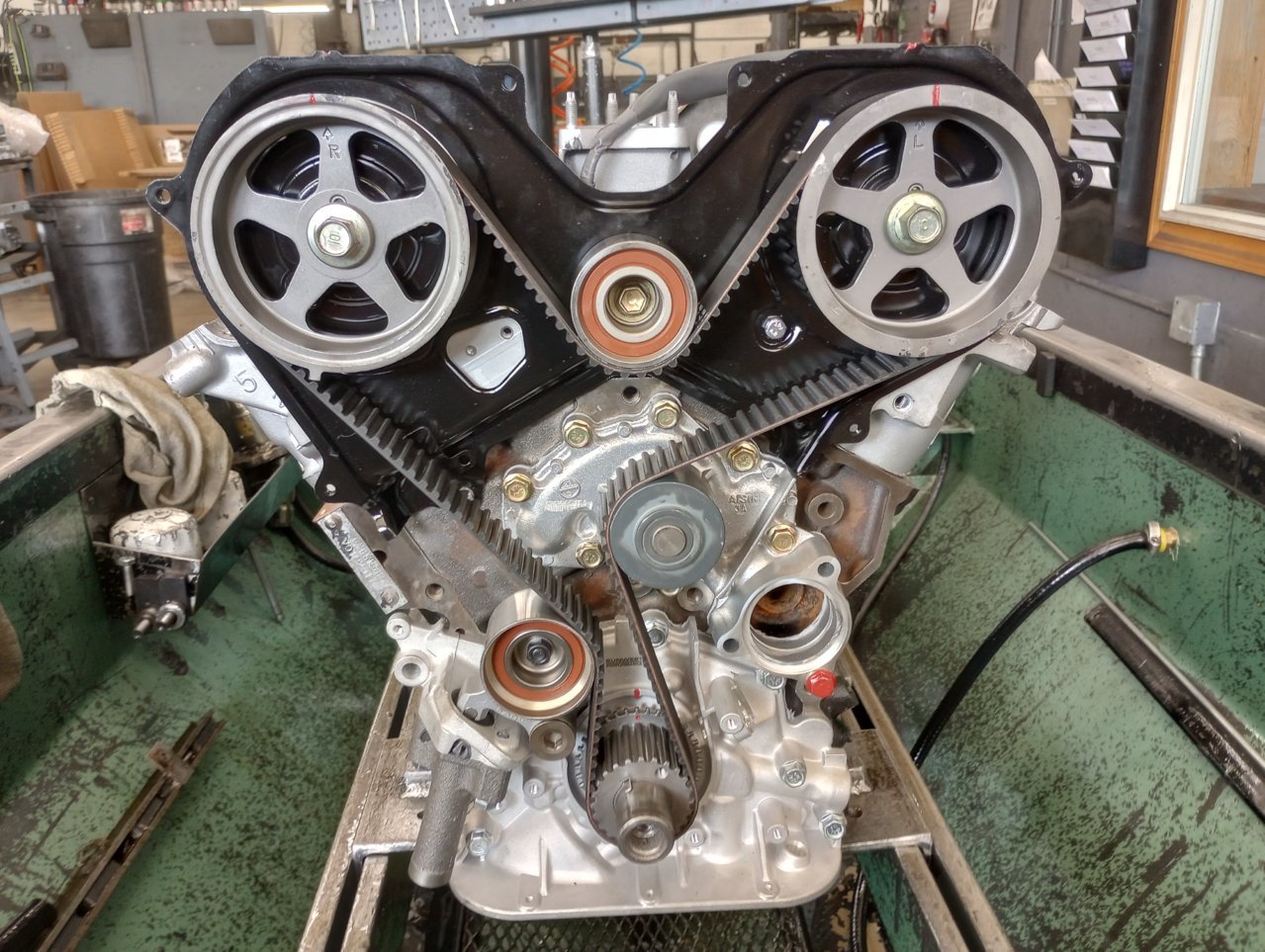

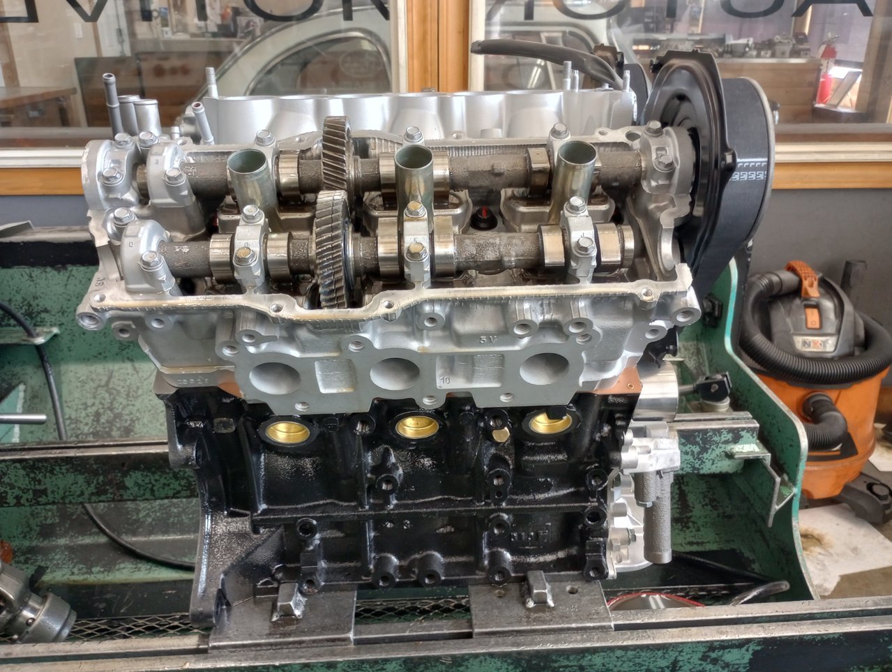

    Got some pictures of the engine in it's final stages before shipping

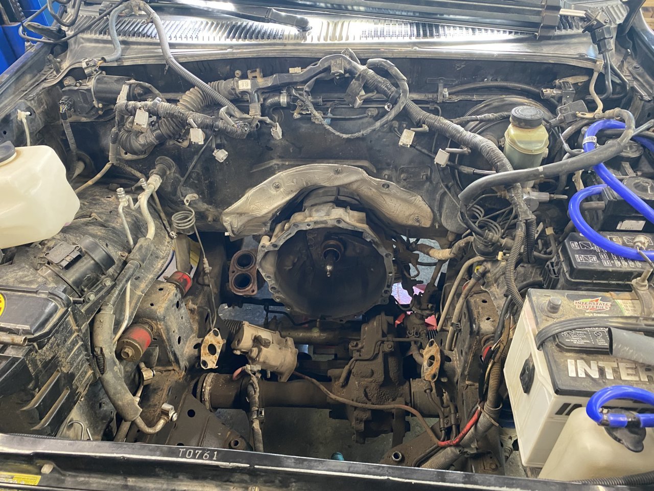

    My 98 has gone in for it's engine replacement. Putting new motor mounts and a new starter on as well. Hopefully there are no huge surprises waiting for me. Has a marlin crawler clutch kit and newer flywheel. I'll post some pictures up when I get it back!
    Dropped off some stuff to the mechanic and he hasn’t run into any issues. He stated how thorough sunwest was at the engine rebuild. He was impressed how they included all the specs and tolerances or a blueprint of everything that was done. No broken bolts and almost has it done in one day.
