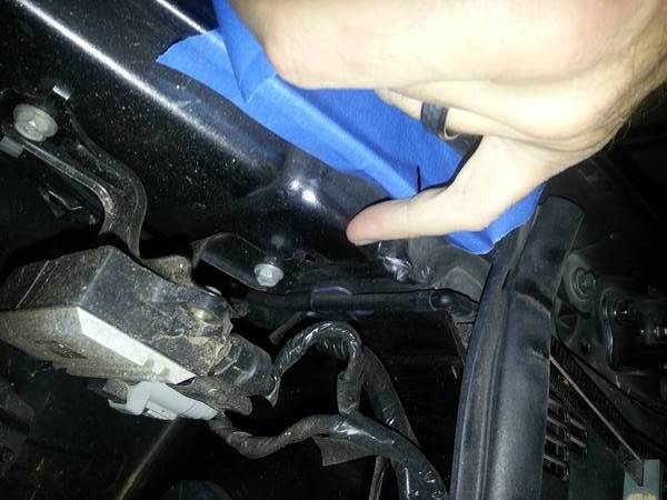

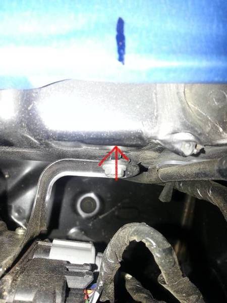

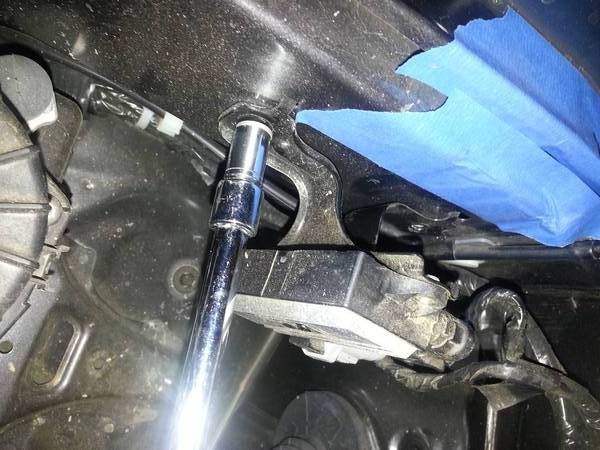

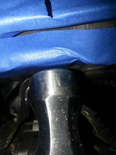

    I had already bought mine when this started, but I installed mine last night. I have a 2012 and there are a couple of tips I have for everyone when they instal the bottom brackets.
    Im not sure that 2011 models and earlier will be like this.
    In the first picture, you are seeing the passenger side. I am pointing to a hump that makes it difficult to install the bracket flat. You will have to remove the electrical block on the passenger side to do this, but i believe overall its worth it. On the drivers side there is nothing in the way of doing this. I just put some tape over the humps and lightly tapped them flat.
    Of course, you can probably get them on without doing this, but I just didn't like that they wouldn't be flat against the truck surface.

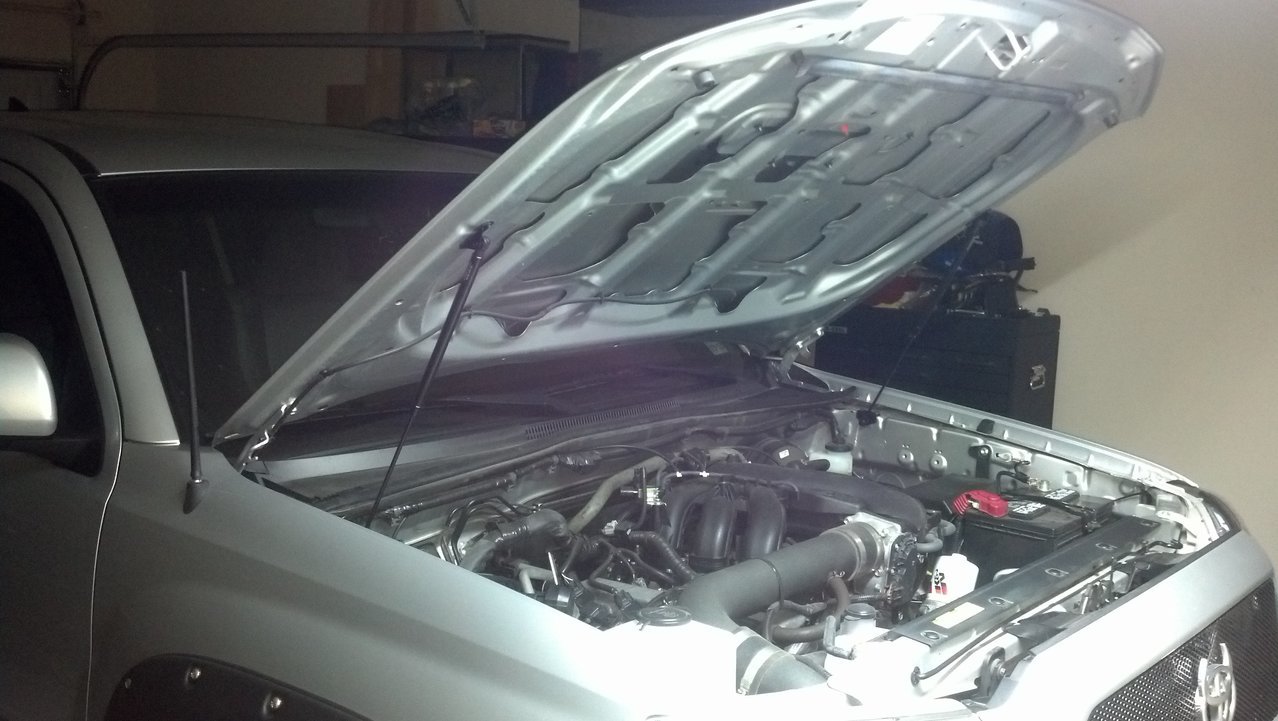

    Installed mine today....finally. Took about 35 mins tops and they are AWESOME! This little mod does so much for cleaning up the engine bay. Not having the prop rod any more.....worth it. +1 OP
