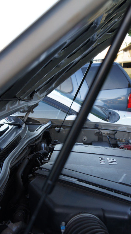

    Pretty easy install. RedlineTuning quicklift came with an installation guide.
    I'm not sure if that kit will come with one. You can always send em an email just to confirm what you'll be getting with the kit.
    The day I installed mines.
