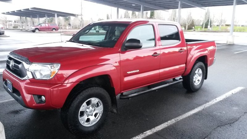

    Looking for Ideas on what type of suspension kit is good for a 2012 TRD 4x4 dbl cab truck. Not trying to break the bank but wouldn't mind spending a little to get a nice lift for off roading here and there.....
    The truck already has a nice stock lift that looks good, but needs a little TLC with accessories wheels, rack, lights.......
    This truck would be a drive to work / go off road camp fish and explore...
    Please help!!! Need ideas!

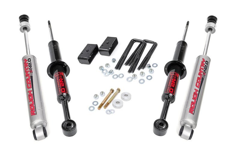

    You're about to be bombarded with posts about Bilstein 5100s. Listen to them.
    Front coilovers: Rear shocks: Rear AAL: A 5100 lift with an add-a-leaf is a budget minded but effective way to increase your capability on the trails while still maintaining a good ride on the street. Off-road shocks tend to be valved stiffer and as such tend to ride rougher on roads.
    Rough Country shocks are meant to be sold, not used.
    I'd go with Fox/King > Icon > OME > Bilstein 5100s > Zone > Rough Country > Pro Comp

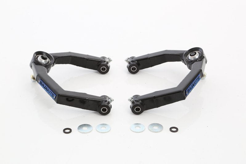

    It really does come down to how much you want to spend!
    Inexpensive route that will get the job done, Bilstein 5100's all the way around, AAL and some $$ left over for other accessories.
    If you want to spend some $$ but want the best, King Shocks all the way around, Upper arm, Full leaf pack etc...
