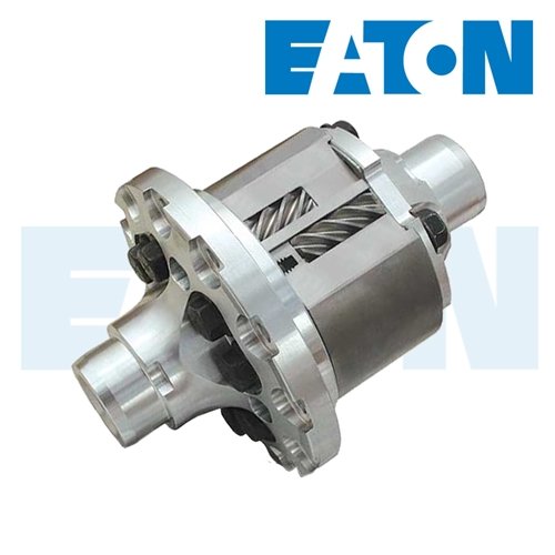

    Have you ever looked at a Detroit True-Trac? Limited slip without friction material to wear out. Not an auto-locker. According to many, it also works well with the Toyota traction control system. Several jeep owners have recommended them to me as well.

    A detroit true trac is probably the best option for a DD without breaking the bank especially when paired with the auto LSD function.

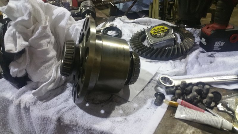

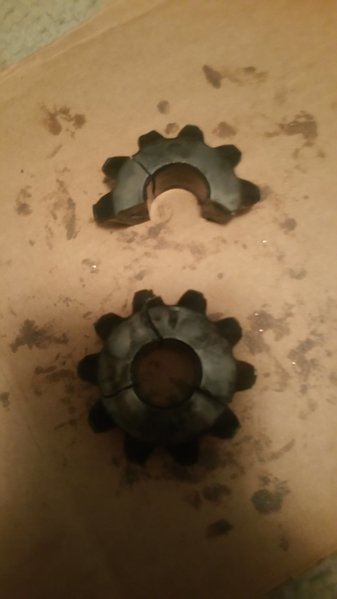

    I have a true track in my 13 due to stock rear end exploding mid burnout. But the true track is pretty bad ass in my opinio . If it sees one tire spend it puts equal power to the other wheel. And it engages so smoothers. No noise and can't tell it's there unless you need it. It has really gave me the ability to stay in 2 wheel drive more often. I recommend the true track for any one. I got mine from Yukon gear and axle the website is randysringandpinion.com under traction device. Around 600 before tax and shipping.
    And no spider gears to break or friction material to have to replace

    When you replace it I would you stock ring and pinion unless you want to read gear it because a new 373 ring and pinion is about a grand from Toyota and Toyota is the only place that has oe new parts.

    I love my TT as well. You don't require anything else but the carrier bearings are damn near impossible to remove and reinstall without damaging them.I would suggest buying two new ones from the dealer before starting. Also some red thread lock.
    There are also rare occasions that require new shims and re-adjusting the backlash but generally that is on rear ends with many miles.
    During normal street driving I can't even tell it's there. The only faint indication is when I turn away from a stop in the rain (on pavement) I can feel it squirm a little. Nothing anyone else in the truck would ever notice.
