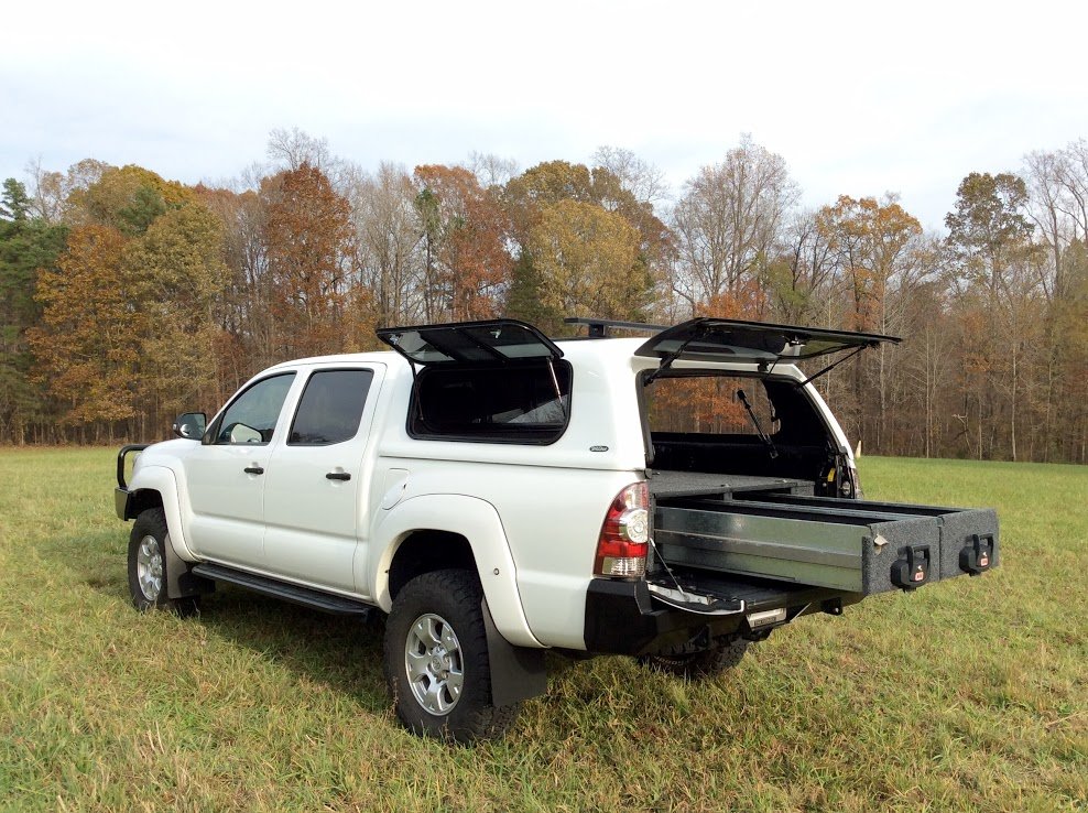

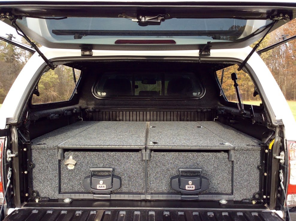

    Not a Third Gen, but I installed a pair w/ a modified Hilux (I think) fit kit in my 2012 DCSB when I owned it. Cavernous storage in both the drawers and the side compartments created by the fit kit. It was nice to have 95% of my camping gear, recovery gear, tools, etc. loaded in the bed and easily accessible. I like a clean, uncluttered, and unobstructed cab. ARB’s products are expensive, but they stand behind them and their customer service is top-notch, IMO.
    I ran this set-up for about 2 years, IIRC and probably put 50k-60k miles on the truck with the drawers installed. No interference with the TC bed stiffeners I installed to compensate for the Snugtop + RTT. Once the drawers are bolted together and then through the bottom of the bed (I used 6x Grade #8 bolts and large Grade #8 flat washers, IIRC) they are planted to the vehicle.
    To echo @nartmot, my only complaint with the ARB design is drawer stops that latch the unit open once extended; they have a tendency to break due to a design flaw. You have to be very careful not to slam them open to prevent this part from breaking. Otherwise a replacement set is around $20-30. ARB sent me four stoppers for free when I emailed them about the issue. Once you break the muscle memory of opening the drawer and letting it ride out full speed to fully extend, it’s not really an issue. You just have to make an effort to gently catch and slightly pull the drawer to full extension until it clicks. Otherwise, no complaints with ARB’s drawer line-up.
    Pics:
    2B39AE0A-1909-493B-B236-1DF4652DF694.jpg F19DF723-382A-4354-9775-2E3A3F01B50D.jpg 8F858629-5C2B-46BB-9D45-DB6CF67FE3B6.jpg

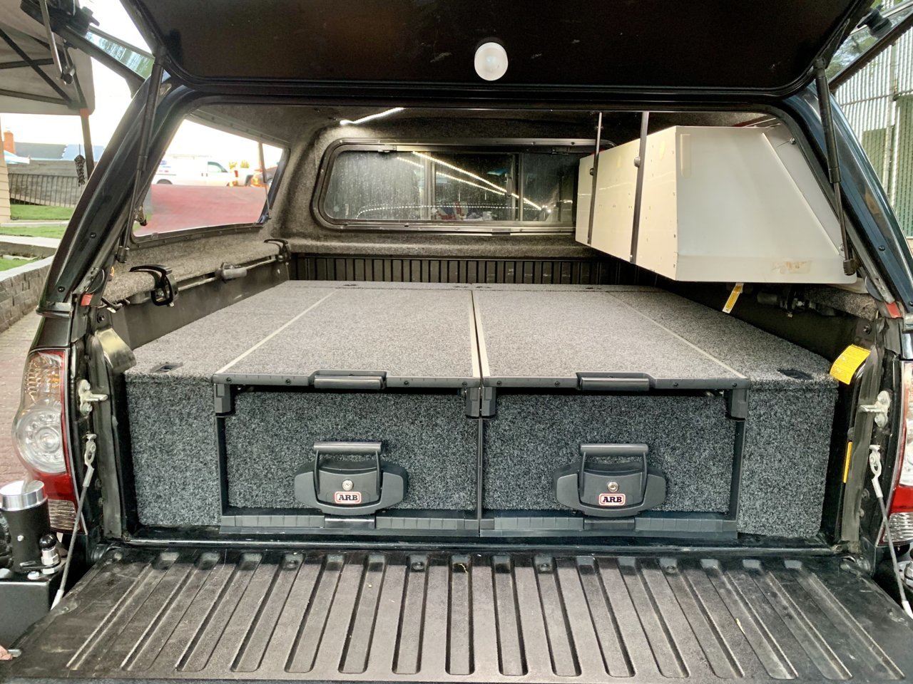

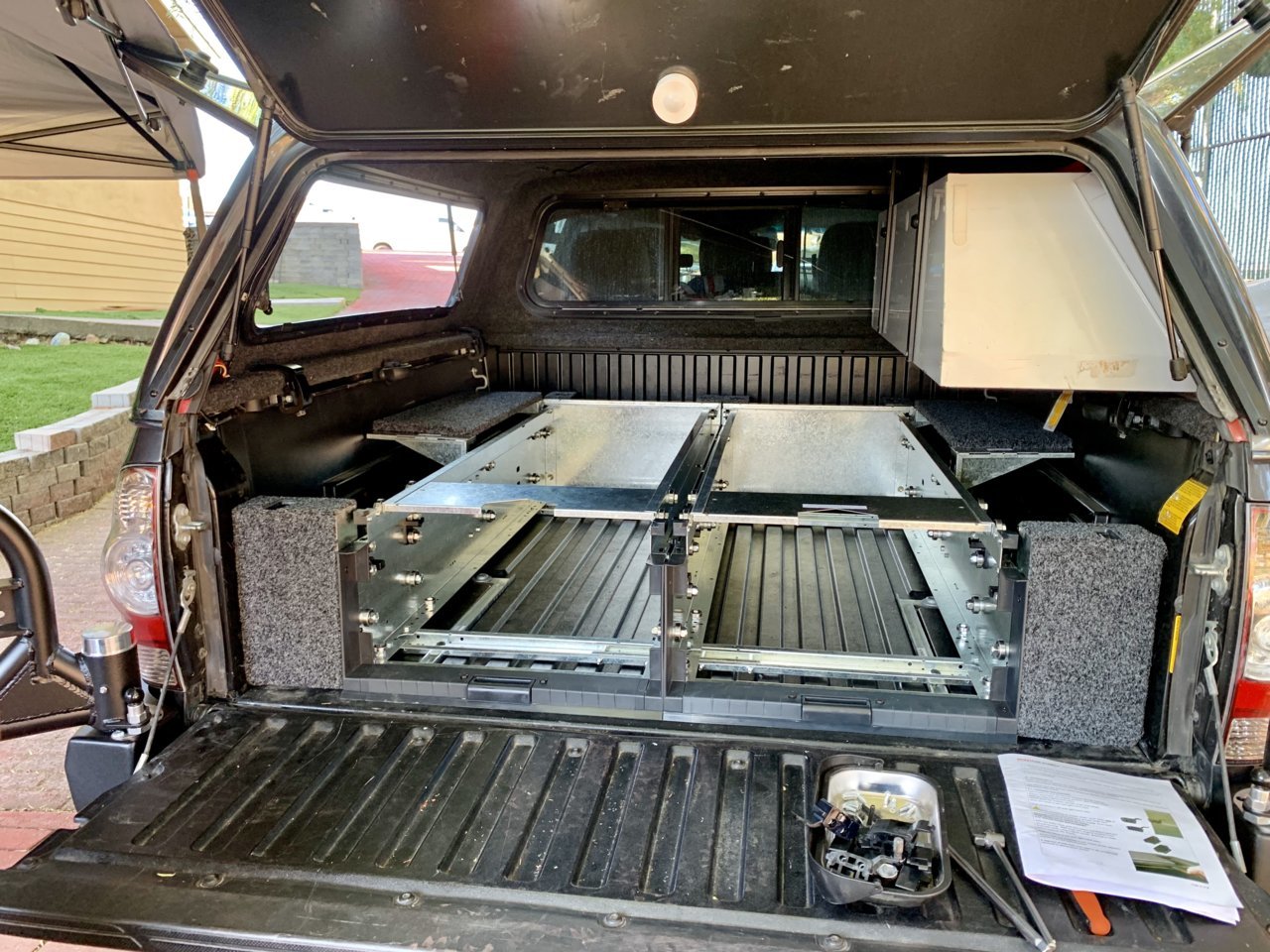

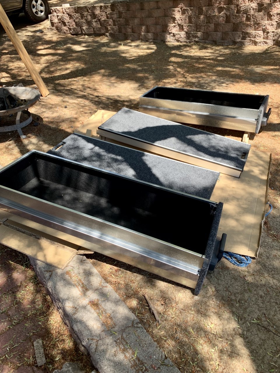

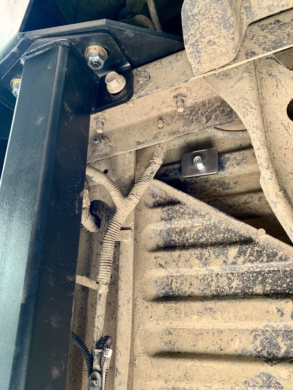

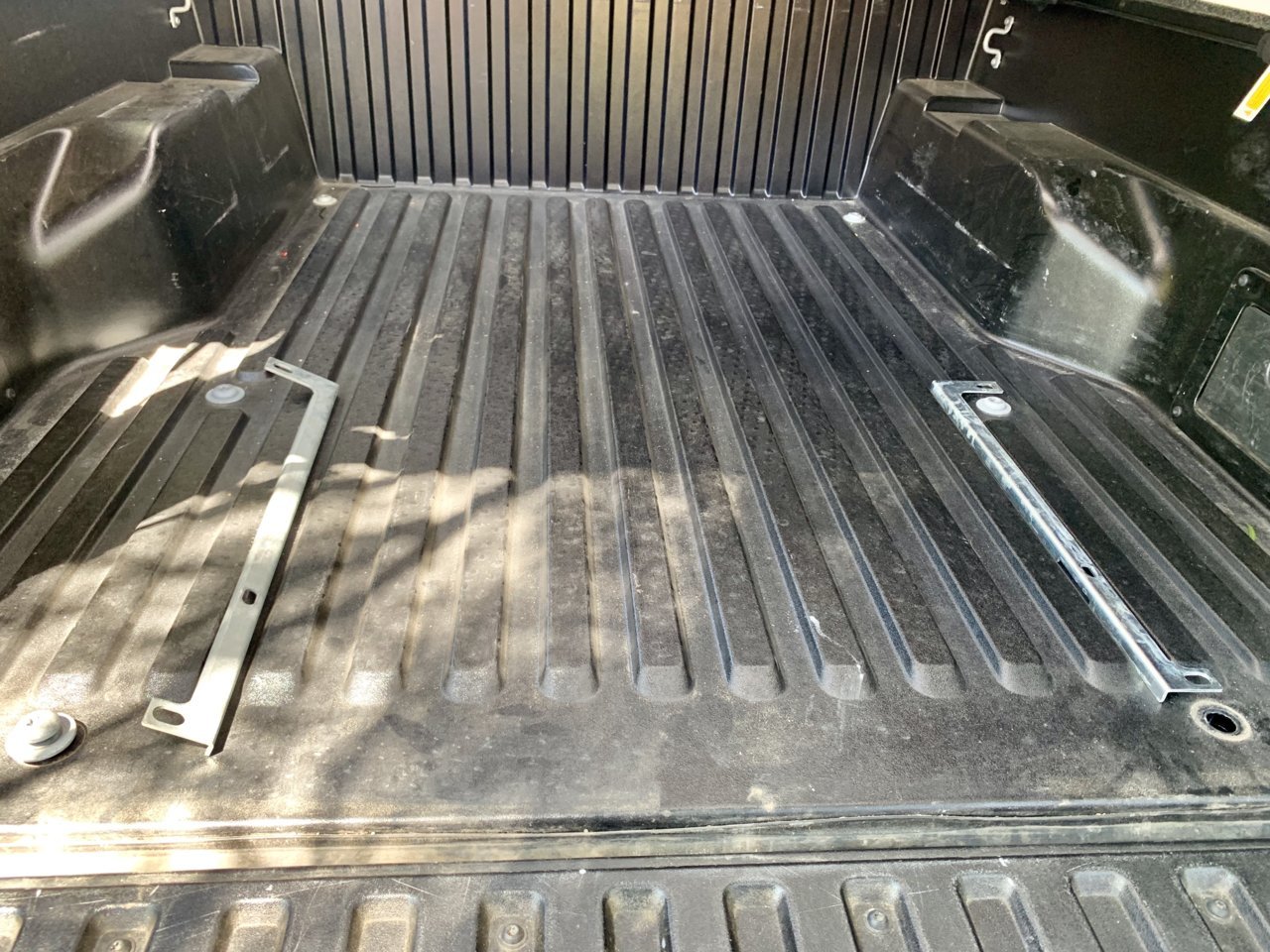

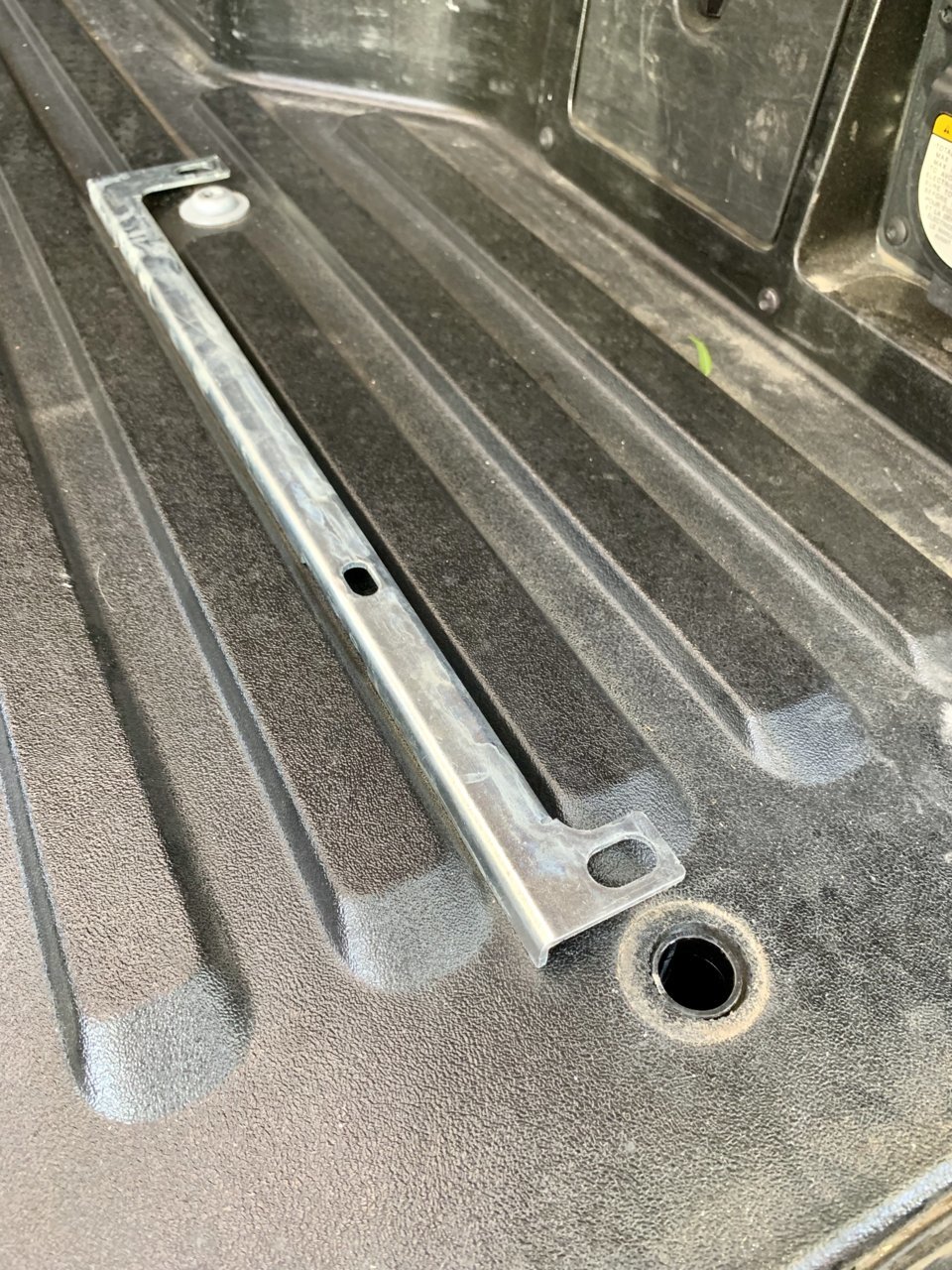

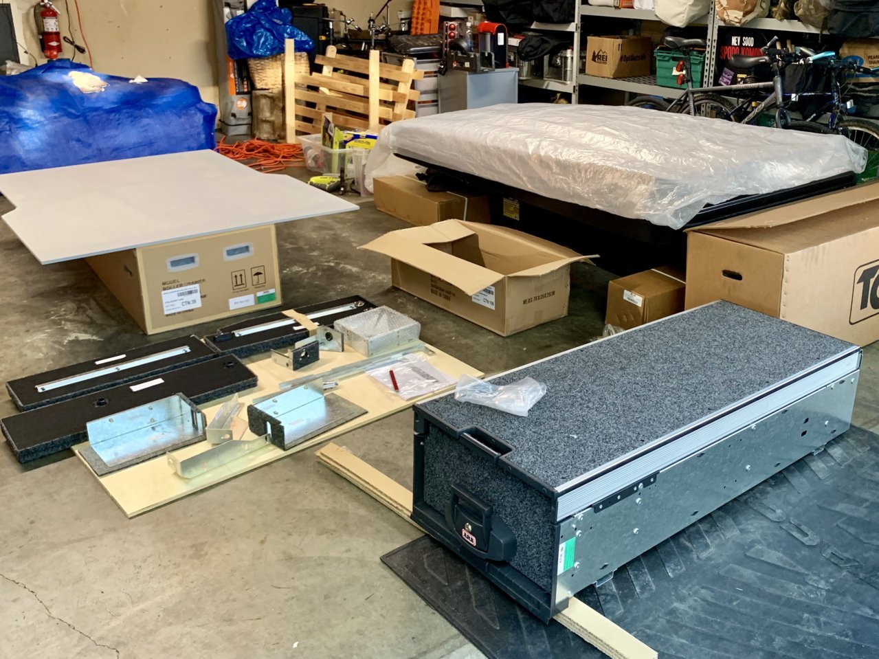

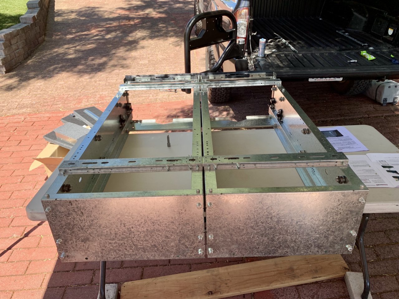

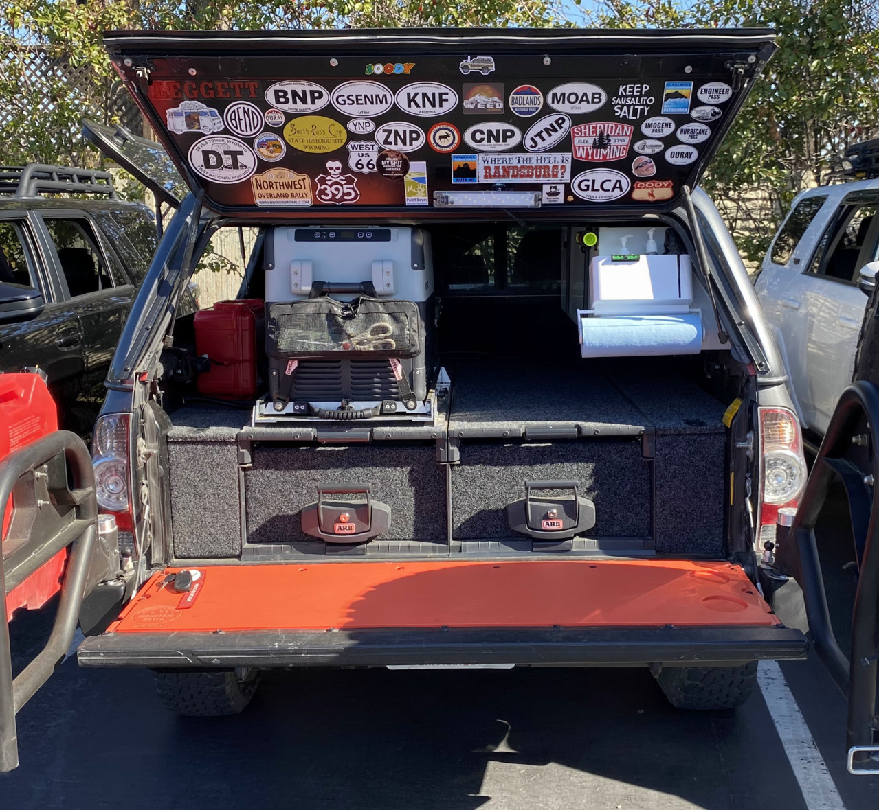

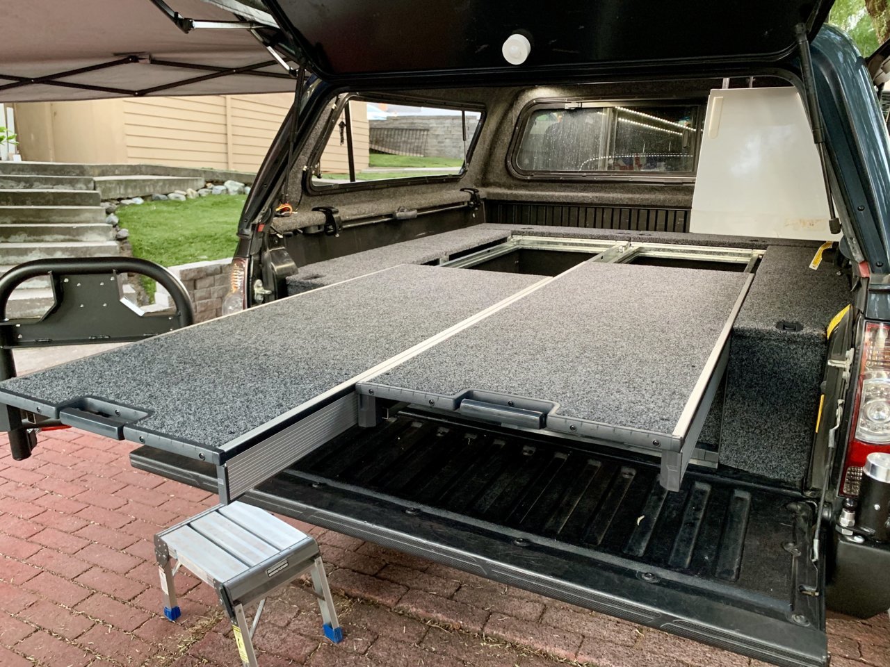

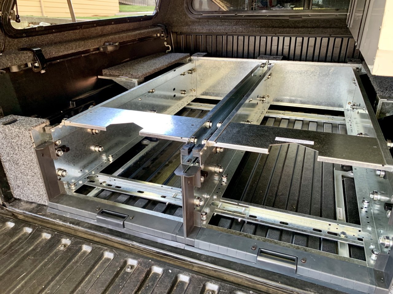

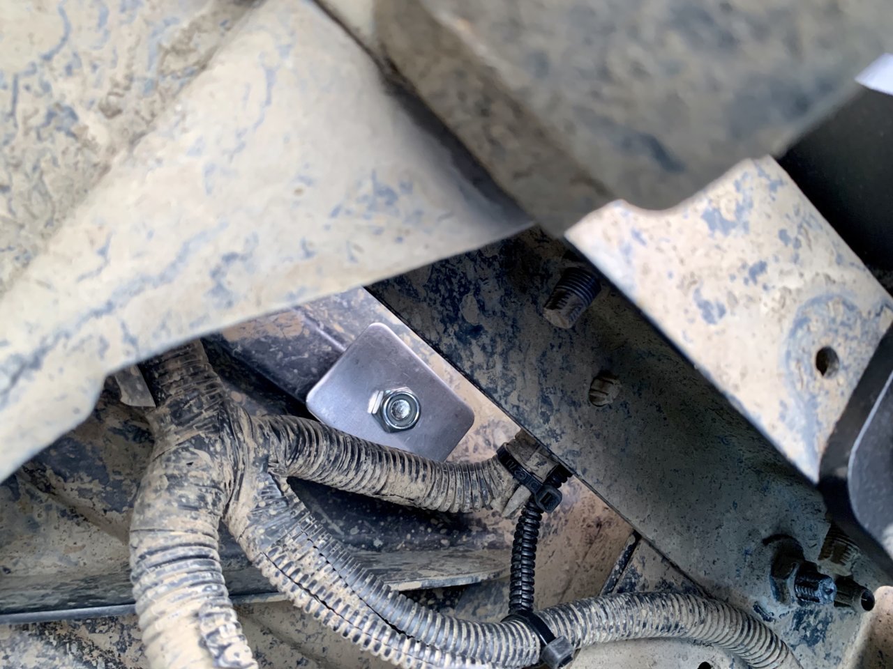

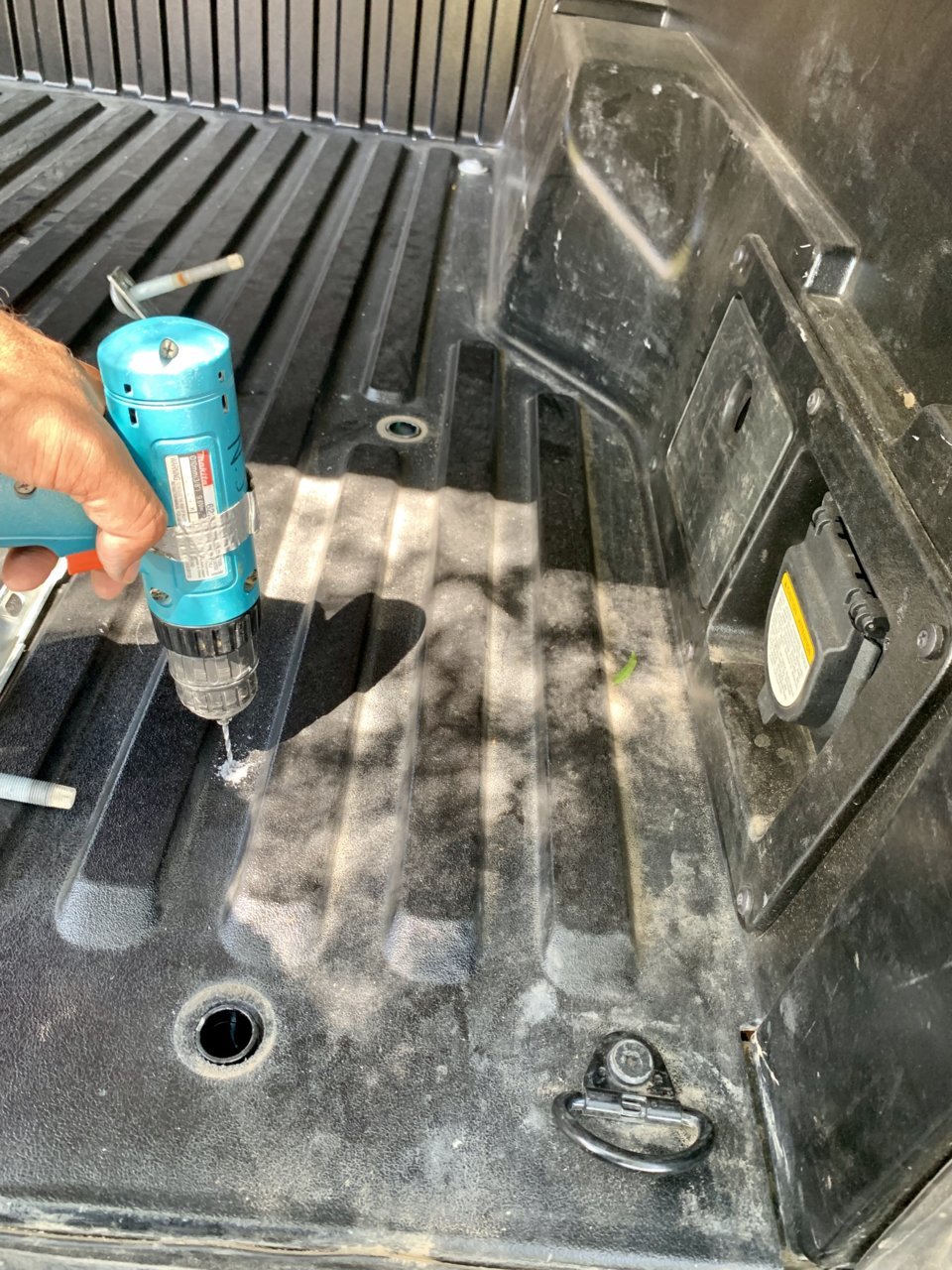

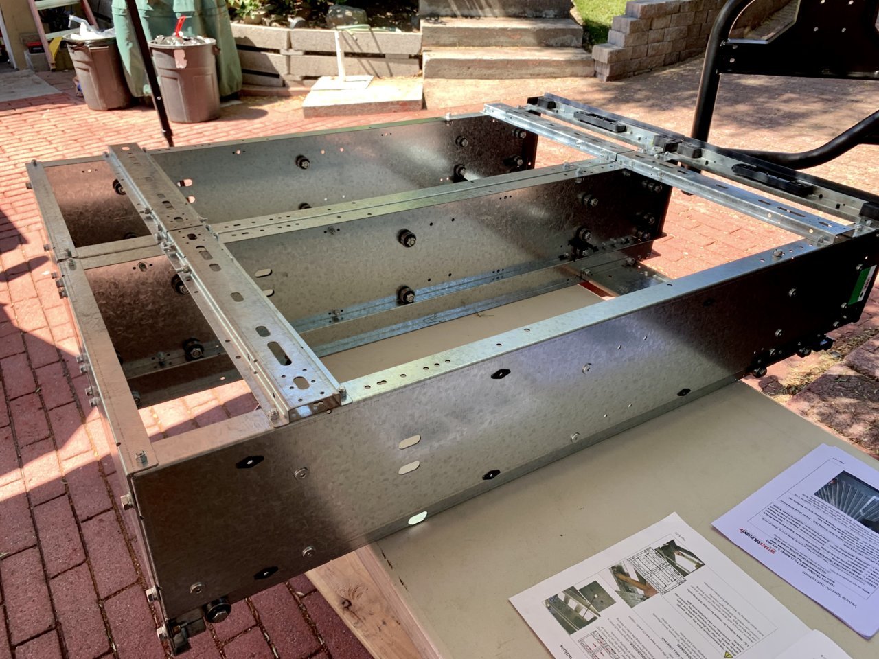

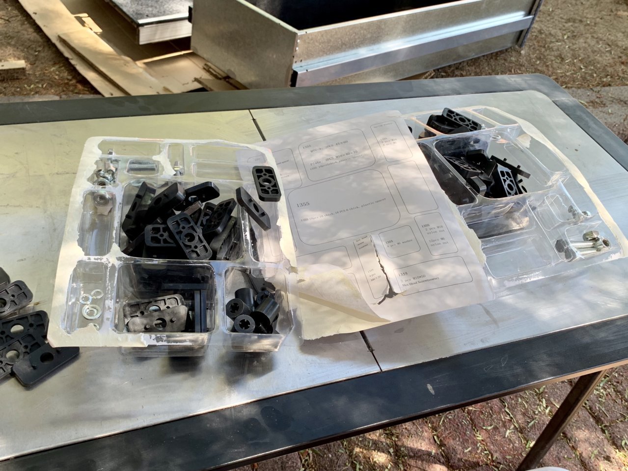

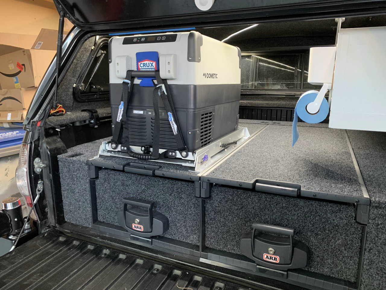

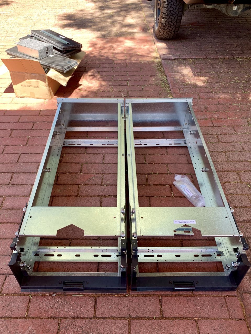

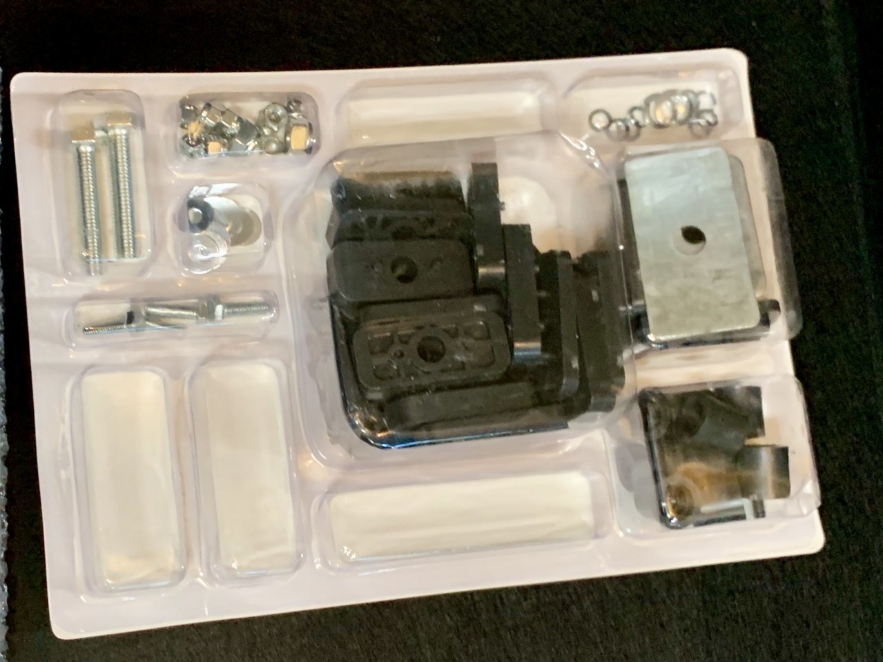

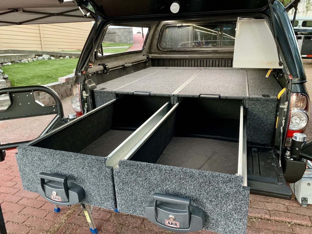

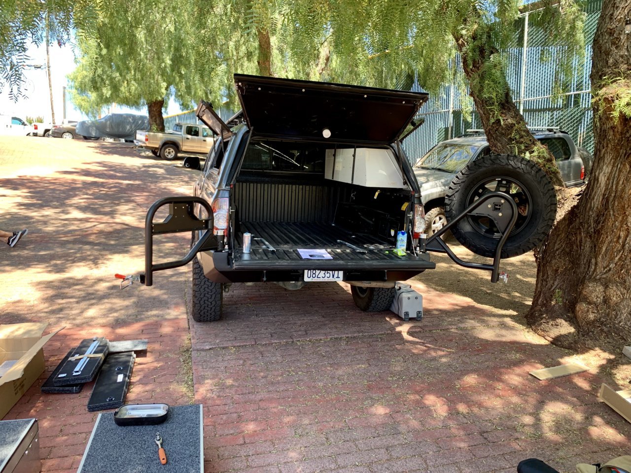

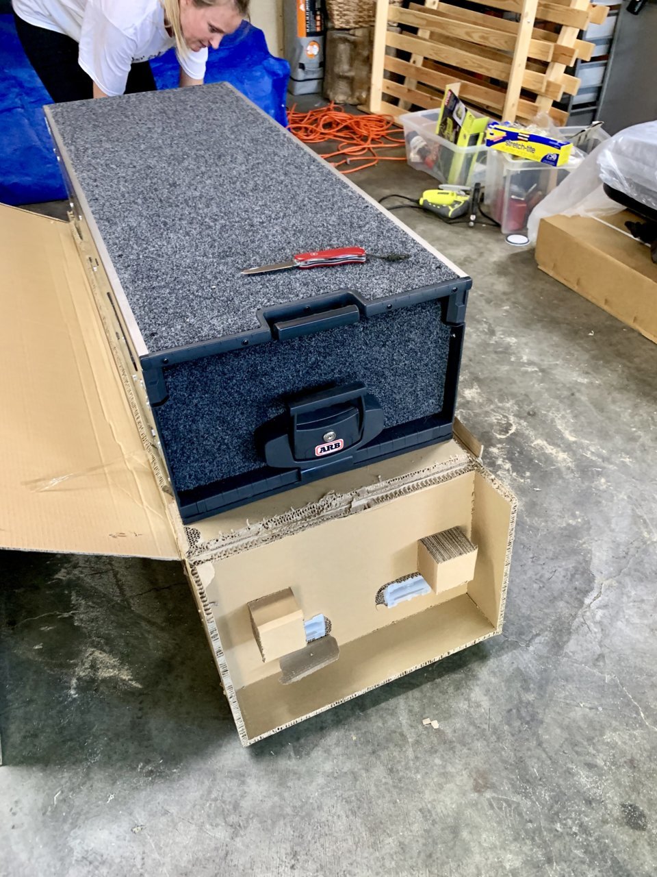

    Sorry this took so long mate.
    I'm not very good at this sort of stuff (and Tacoma World only allows uploads of one photo at a time so this took over an hour to upload), but here go's....
    So my wife and I installed the drawers in August of 2019 and they have been now been on several Muti-week off road / overland trips including Baja Mexico. So far so good.
    The install is straightforward to anyone with basic skills and patience - it took us about 6 hours to complete the installation.
    In terms of drilling into your bed - only 2 holes need to be drilled in the bed, the system relies on existing holes for all other anchor points.
    We bought the drawers from 4 Wheel Parts (they had a no tax, no shipping promo). We ordered the full length, deep drawers with slides on the top - so we could easily extract heavy gear and save our spines!
    The exact model no. for the Tacoma short bed (5ft) is : ARBRDRF1355
    ARB Outback Solutions Roller Drawer with Roller Floor - RDRF1355
    We also wanted the ARB Side Panel kit to finish off the install and have usable 'storage bins' in the space lost due to the wheel arches. We had to contact 4 Wheel Parts Customer Service directly to order this as it was not listed on their website.
    The model no. is: TACODRAWKIT.
    The drawers arrived in a box each and the Side Panel Kit in a third box.
    You will need:
    Metric socket set
    Torx T55 for the bed fasteners (THIS IS A MUST HAVE)
    Drill and some small HSS drill bits
    Cold Beer
    Help in the form of a patient partner (wife in my case)
    Band Aids
    the ARB kit is modular for different vehicles, but is fairly straightforward to follow the instructions - make sure you READ THE SIDE PANEL KIT INSTRUCTIONS FIRST!
    It will save you time and pain and make the installation easier - the instruction for the drawers are generic BUT the instruction oof the side panel kit ARE FOR THE TACOMA and cover the complete installation.
    The kit comes with a massive fixtures pack - enough o cover every type of vehicle.
    The drawers come pre-assembled - you need to take these apart and join the two frames together. Fix the two anchors (drill 2 holes and use supplies waterproof fasteners, and use existing anchor points for others.
    Mount the frames for both drawers. I have a topper and The trickiest part is installing the side panel kit as you have climb over and lay on the drawer frames. The side panel kit bolts to the drawer frames and has nice catches on the panels to access the 'cubbies' down the side and back.
    We then installed a Dometic Fridge on a DFG Tilt Slide Fridge Mount - works really well and overall very happy with it. Also an Outer Limits First Aid Kit to the left of the fridge.
    This is a solid, well engineered drawer system from ARB Australia - its designed for off road and long overland trails. The carpet covering is really high quality and repel moisture and keeps itself looking clean and neat.
    The down side is, it is heavy - I'd say around 140-150 pounds.
    IMO you need upgraded leaf springs - I have a CRX Topper with a Baja Rack and a Simple Outdoors hard shell RTT. I initially upgraded to the ARB Old Man Emu Dakars 600 pound springs but just upgraded again, to the Deaver 1000 pound expedition leaf pack.
    I've posted the photos in order of installation - happy to answer questions!
    Cheers, Nev

    great install! That dometic is the cherry on top :)
    PS which tailgate insert is that? Mountain hatch?

    Yes mate - Mountain Hatch Tailgate cover. Its not the cheapest for a chunk of plastic but it is very high quality and it makes a massive difference to making a coffee, food prep, or just sitting have a beer on the tailgate - compared to the factory 'ribbed' insert !!! Well worth the money and a must-have for longer overland trips.

    so this looks like it comes out quite far, maybe not compatible with a bed stiffener?

    Hi. Nice build. Really appreciate all of the pics. I'm looking to do something similar in my Taco.
    Question: Are you able to fully extend the ARB roller floor and then extend the DFG slide and tilt the fridge down? Just wondering if you've found that doing so places too much stress on the ARB roller floor.
    BTW: Which model of Dometic fridge do you have?
