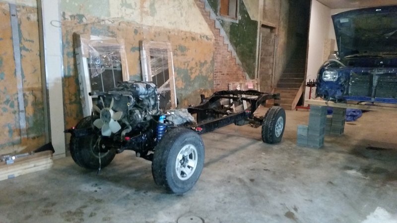

    Pretty much your just gonna want a Extended cab frame in general . Any year will work but all 3 cab configurations are different . And between the transmissions the only difference is the tranny mount crossmember . Frame horns are slighty different on 98-00 models but they make adapters that you weld on to fix that . The rear is the same except 98+ have leaf spring mounts that are more spaced out and the gas filler neck is slightly different on mounting . Picture is my 97 on a 2001 frame
