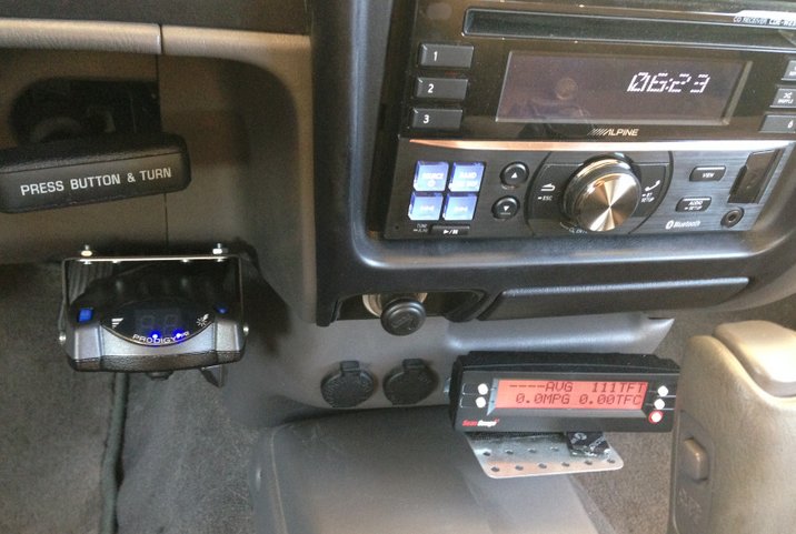

    I got the 235BT and it has worked really well for me. Never had bluetooth before and now it's so easy to play music from the phone and to have phone calls run thru the stereo speakers.

    Forgot to include pic of the 235BT.
