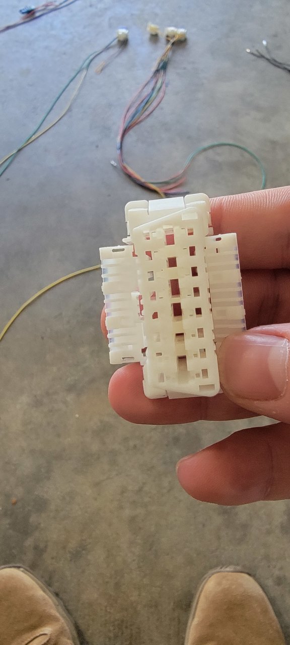

    Also the OBD connector part number is
    90980–11665 or 90980–11978
    and can easily be swapped out if needed. De-pinning an OBD connector is one of the easiest connectors to do.
    There is a section on the top and bottom of the connector that need to be pried up to release the hold of the pins. In the attached image below, you will see that the tabs are up as I have not installed the pins in mine yet. Once they are up, just get a tiny flathead screwdriver to push the pin retention down near the center of the connector and the pin will remove with ease. Do that for the remaining pins.
    To install a new connector, just work backwards. Insert all the pins until they click in place, fold the top and bottom flaps to lock the pins. Easy day.
