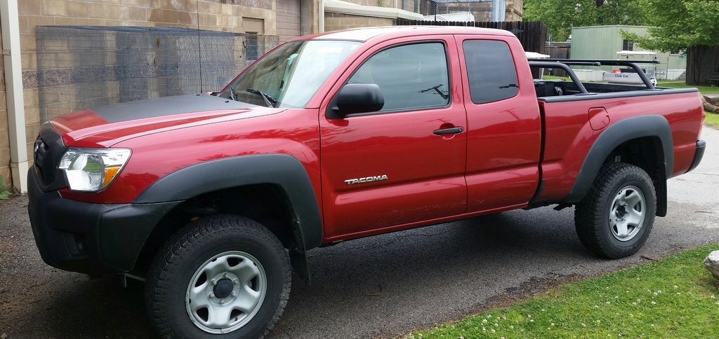

    I currently have no cab rack, nor any tall crossbars over the bed; I have this lower-profile one that I picked up to rest the rear tires on while transporting bikes on my fork-mounts: [​IMG]

    Where did you get that bar? Looks awesome and could be a good starting point for a canoe rack.... maybe mod that to make it taller? Ive been trying to think of the right design for this too.....

    I took one of those generic racks and had @phillstill weld some small tabs on the bar. This allowed me to bolt it in on the rail system using t-slot nuts.
    Haven't had any issue with it yet. I upgraded my straps to 25' long so that I could secure it to the bed as well as to the rack.
    This is the base rack: http://www.amazon.com/TMS-PICK-UP-RACK-650-Pound-Adjustable-Utility/dp/B009VOQ05U

    Your bar looks like the relentless fabrication bed crossbar, short version. I got two of their taller versions, had them weld two tabs on each one so I can mount the standard thule rack bar across. This easily holds two fishing kayaks below the cab (don't like above mount for mpg etc). I can easily get things in and out of the bed, and when not hauling boats I can remove the thule bars and use them for a RTT - they also have the HiLift mounts on them as well. You can kind of see what I am talking about in the pics. The second one shows the mount for the thule bars, did it with stainless allen bolts the have the rounded tops. Works a charm. The eye bolts are where I attach my ratchet straps. The boats are 10 footers, so hang of back some, but I have driven from Oklahoma to Wisconsin for two weeks with no issues.

    Got it locally off a guy on CL. He said he had a pair of them fab'd at a shop, but the other one was left on the truck when he traded it in. I've looked at pictures the Relentless bars, and they look exactly like mine does - so who knows...
