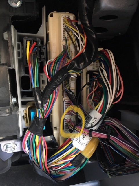

    Can anyone supply a part number for a replacement/repair terminal with or without attached wire (of any color) for the circled connector shell shown in photo? It's the bottom connector of the 6 that plug into behind the right side of the glovebox.
    Thanks

    A photo of the front would help. Also if you can count the number of sockets it has would also be very helpful.

    I believe that's a 14 pin, two symmetrical rows of 7. It's probably connector 90980–11911 (this is the white plastic part) and the repair pigtails will be 82998-12690. Those will 160mm long wires with the terminals crimped on.

    Thanks Dave! Yes, it is a 14 pin connector. I will get a couple of the terminal/pigtails ordered soon. I assume that these are pretty standard, and are used in a lot of the connectors throughout the truck?
