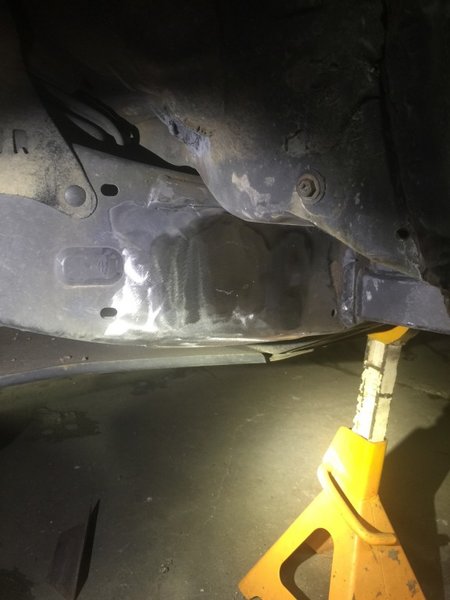

    I ran the same lift, same tire size and same wheel setup and it rubbed on the street at full lock in reverse.

    You don't have to do a CMC, it won't hurt the tires to rub a little in reverse it just sounds kind of .. whack I guess. You could also go with 255/85 and not rub at all if you flatten the pinch weld.

    The owner of the truck says that a couple people he knows just took a BFH and dented the cab mount in a bit where it rubbed. Personally, I'm more hesitant to start wailing on the cab with a hammer than I would be to saw and weld on it. I guess if he's OK with it and he's the one PAYING for this, I shouldn't feel so inhibited, but I just hate charging someone for a job that in my opinion isn't quite right.

    Could just relocate it .. lol
