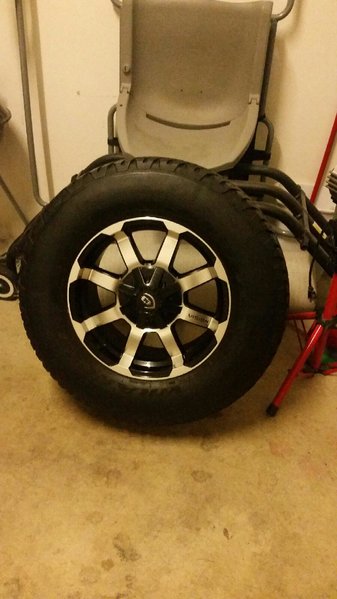

    I just recently got a set of vision valor rims and tires and have been unable to install due to needing aftermarket lugs and swapping out tpms sensors. Should be getting it all taken care of tomorrow or the next day. Wanting to get a better idea of what its gonna look like and what everyone thinks of the specs. So if you have something similar, please post pics. Im looking for a little bit of a wider stance look and am wondering if im going to need spacers down the road. Would like to avoid that route depending on how they look once i get them on as i have heard a lot of negative things about the spacers. But i got a screamin deal on this set and could not pass it up.
    Wheel specs
    Backspacing: 5.47
    Offset: 19
    Tire specs: 265/70/17 wrangler AT with about 50% ish tread.
    (will eventually be upgrading those tires so please feel free to chime in also on possible tire sizes given my mods. Definitely wanting a mud tire.)

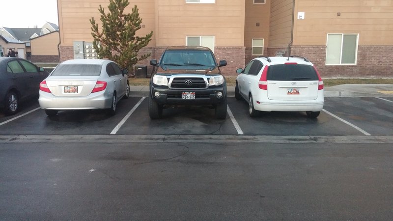

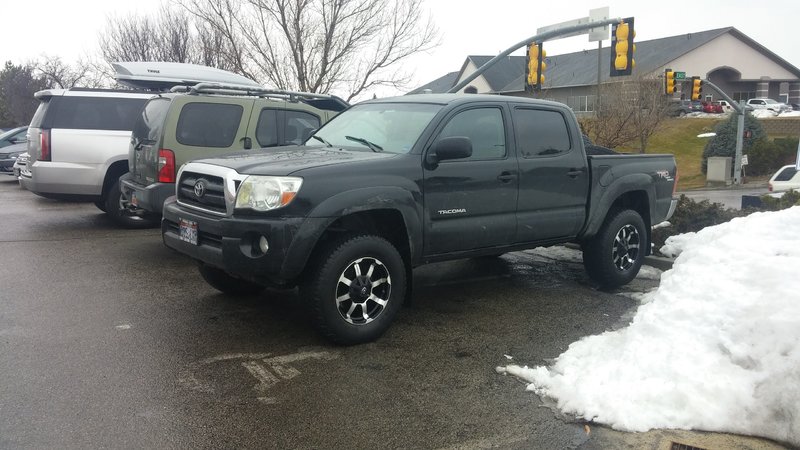

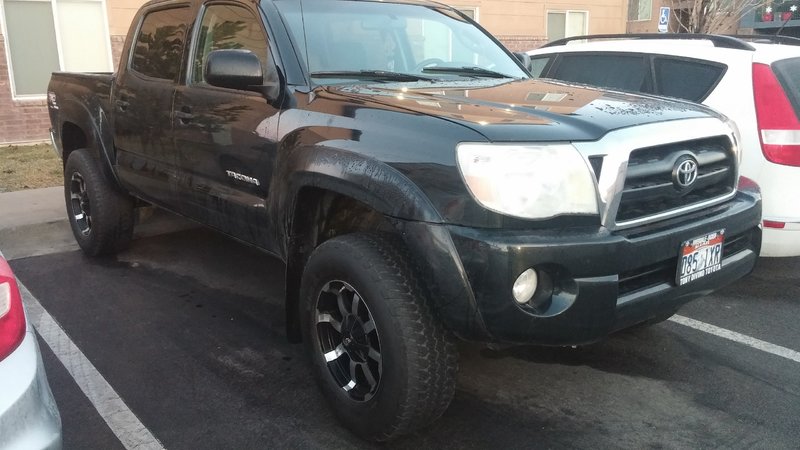

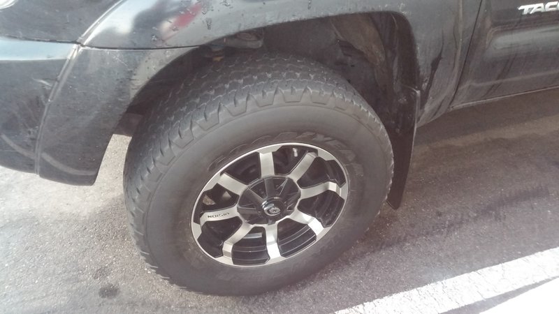

    Just wanted to update everyone with how it went so people can use this as a reference.
    Taco: 2008 TRD offroad
    Mods: 2.5" front 1" rear leveling kit with diff drop and sway bar relocation.
    Tire size: 265/70/17
    Rim size: 17"x8.5" bs 5.47 offset approx 19
    Have slight rub on the mudflaps. Very minimal. Tires are only 40-50% tread.
    Slightly wider stance than stock rims given the bs and offset.
    Going to check local laws on mudflaps and either trim or remove them.
    Thanks for reading!
