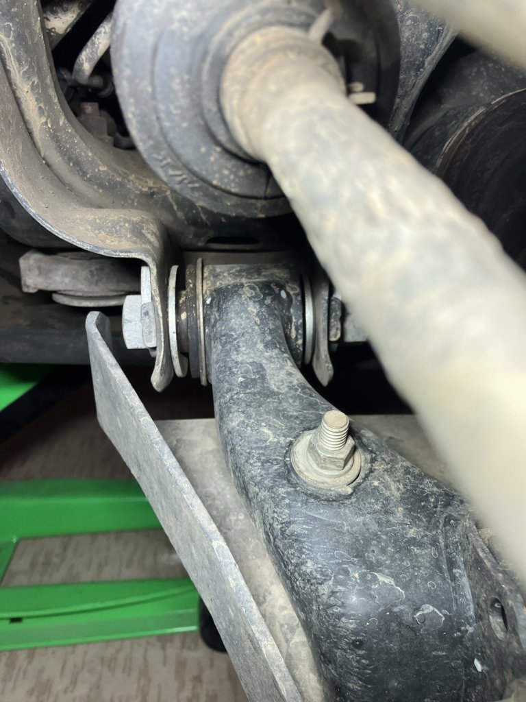

    Long story short, I'm chasing a front end popping noise. I've checked all the usual suspects, and none of them seem to be the problem. My last stop is the lower control arm bushings, and while inspecting them (they don't look warn out by the way) I noticed what I think is a lot of space between the control arms and the frame mounts. Could the whole LCA be sliding forward/backwards making the noise? Attached are what mine look like. Anyone have pictures of their OEM LCAs installed in place I can compare to?

    Thanks. Looking at 2:12 in that video, it sure looks like there is a lot more free space in mine than there should be. My frame mounts don't look bent or anything, so not sure what is causing that. Any ideas?

    Your LCA looks fine. Due to the camber/caster adjustment the bushing will move slightly and look like your photo

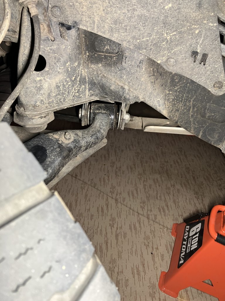

    Not installed, but the bushing looks the same. I think your popping noise is coming from somewhere else.
