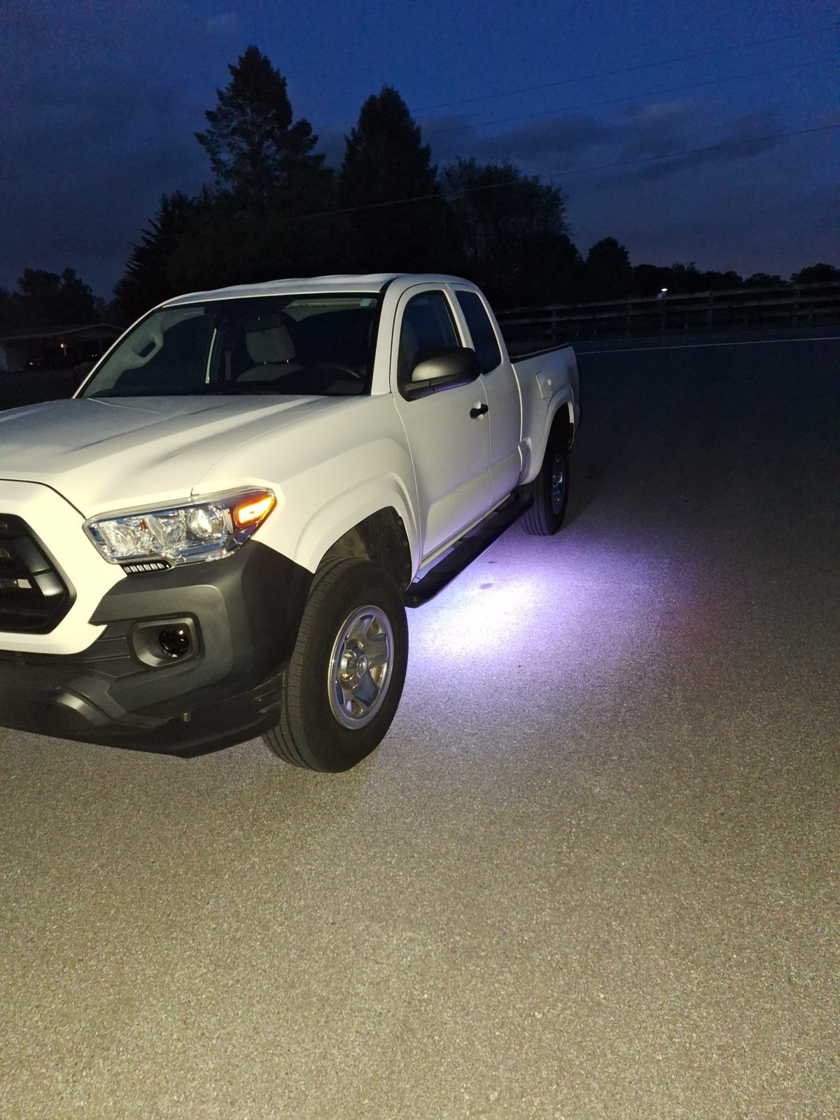

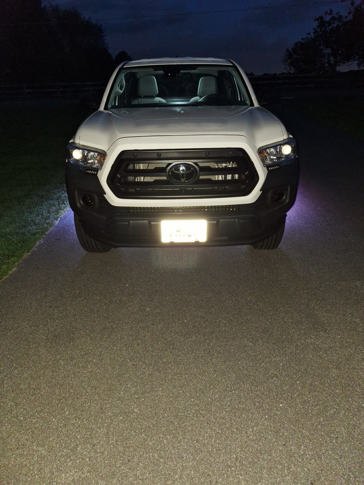

  9. May 12, 2024 at 6:00 PM
    Tacoma Mark
    Tacoma Mark [OP] Member

  10. May 12, 2024 at 6:01 PM
    Tacoma Mark
    May 9, 2024
    #449465
    19
    Maryland
    2020 tacoma sr
    Black out fog lights, black out bar light, black out marker lights (raptor grill stye), DRL marker lights (uner headlight), remote start and door locks, sun visors with vanity lights, extra fuse box, peddle commander, under hood light, hood struts, heated seats, anytime camera and step lights. Painted headlights, added fender flares and installed indestructible vinyl on sides. Seat covers.
    Makes getting out so much easier.
  11. May 12, 2024 at 6:32 PM
    caribe makaira
    caribe makaira Well-Known Member

    Where did you place them? pinch weld of body?
  12. May 12, 2024 at 6:43 PM
    Tacoma Mark
    May 9, 2024
    #449465
    19
    Maryland
    2020 tacoma sr
    Under side rails.
