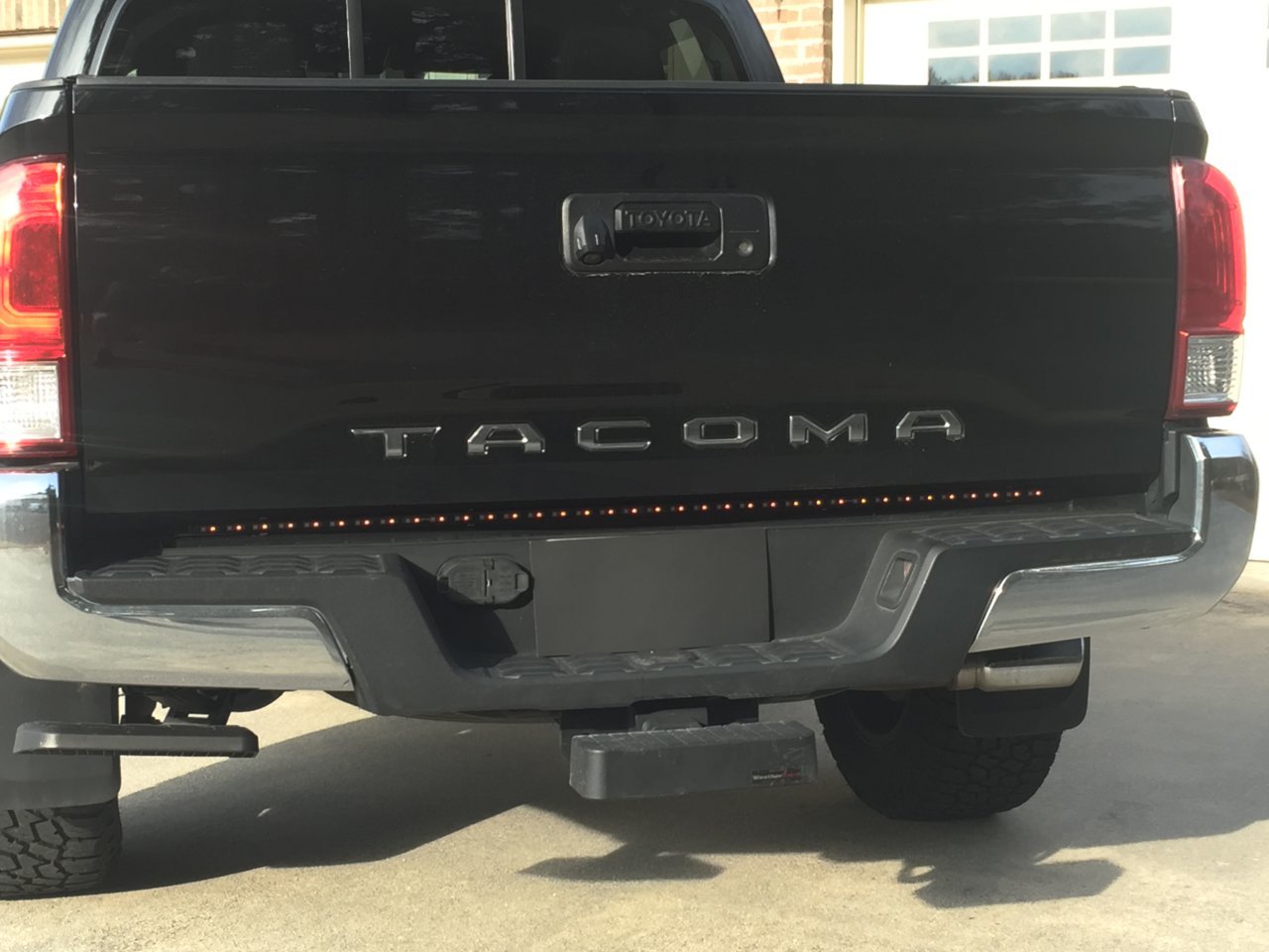

    I have the Opt7 with 3 rows in red. I like it. I mounted it with 3M velcro (the good stuff) so I can take it off to get the spare out. It's held on very well.
    This is the velcro I used. It's pricey but industrial strength. I used four ~2" strips.
    https://www.amazon.com/gp/product/B007OXK1M8/ref=oh_aui_search_asin_title?ie=UTF8&psc=1

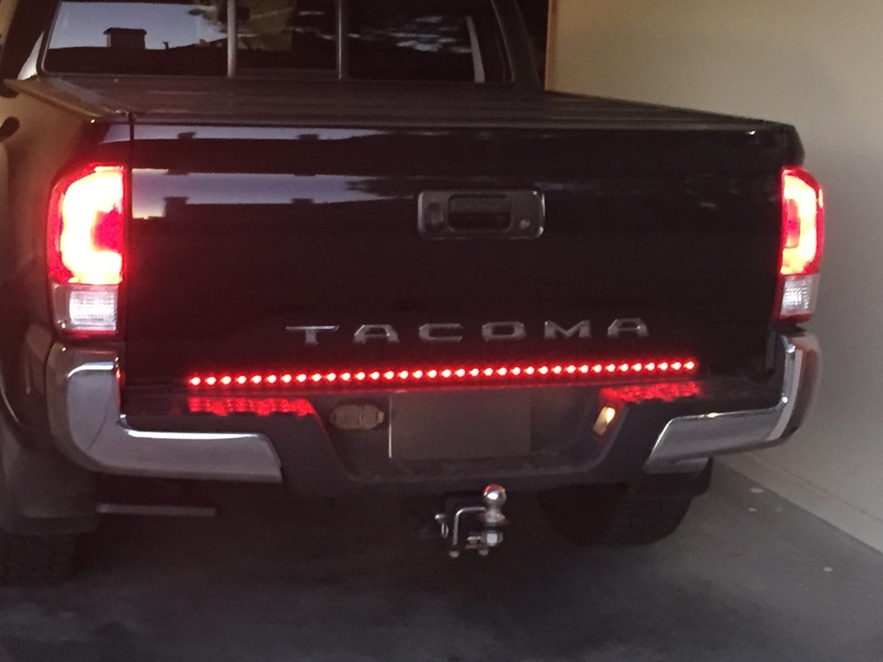

    The OPT 7 Redline single LED light bar is not just red. It has all the features : on, brake, right/left turn signal AND the reverse white light. The triple does give more LED's and the sequential turn signal i.e Mustang style..
    admittedly would not have gotten a strip that just had the red only...
