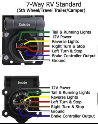

    I went the 'hardwired' route and cut the wires on the lightbar and tapped into the appropriate colored wires on the backside of the tow harness.

    Ahh okay. I'm planning on using the wiring harness and splicing the reverse cable into that. I'm guessing you also spliced into your taillight?

    Nope. Tow harness encompasses all the wires you need to splice into.

    All you need to know if wanting to hardwire.......
