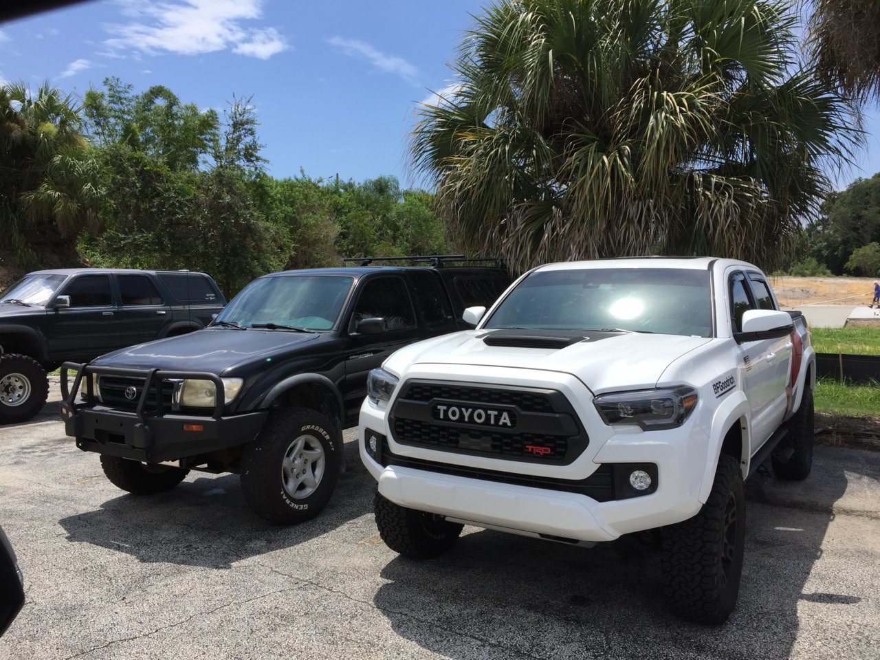

    Glad it turned out good. Would love to test drive it. Been planning on a regear for my 17 one day. All my money goes into the 98 in pic.

    Nice! The white truck next to yours is actually mine. I'm happy with what I have but kind of feel like I should have went with the 5.29 gears. The RPMs are still lower than I want. I think my next mod will be OVTune.

    Yeah, I pretty much knew that was your truck. HAHA Sick looking truck for sure. I have gotten used to my 17 by just driving with the ETC button on. I was sport shifting for awhile but that got old. I paid mine off a year ago so I'm just living with it. I'm honestly used to it but it used to drive me crazy. "40k for this!!!" I'd yell as I drove along LOL Glad I kept my 98, it drives perfect. Agree, 5.29s would be great, especially if you weight her down with mods.
