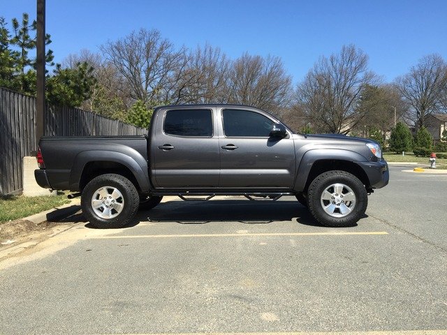

    Mine with the same setup (with 2+1 leaf pack):
    Front: 21" from center of hub to fender, 36" from ground to fender
    Rear: 22" from center of hub to fender, 37" from ground to fender
    Both sides are pretty much the same (I have the 1/4" spacer on the driver's side to correct the lean).
    Also with +1 tires (265/70/17)
    A couple of pics:

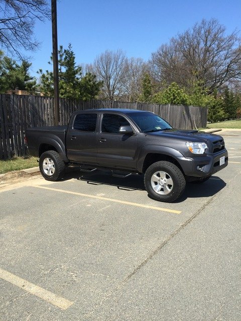

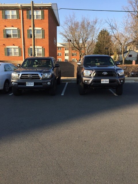

    I agree with rngr. In fact, I had been PM'ing him about this issue last week before I installed my 2" lift. I didn't do a diff drop, nor did I do a carrier barring drop. After having the lift installed I have no vibrations and it would have been wasted effort, and potentially caused new vibrations, had I installed the cb drop.
    I have the same lift as rngr I believe except I have the 1.5 Toytec single AAL. I couldn't be happier with how it drives and looks. Although the pictures might not show it, it still has factor rake.
    Comparison...

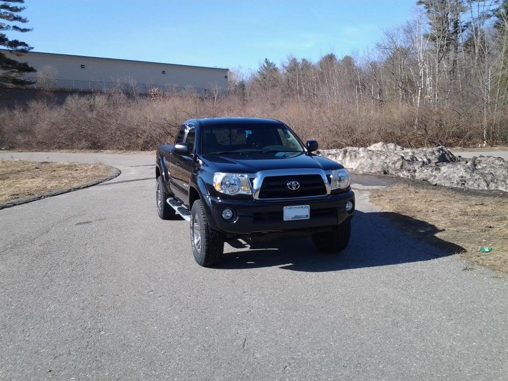

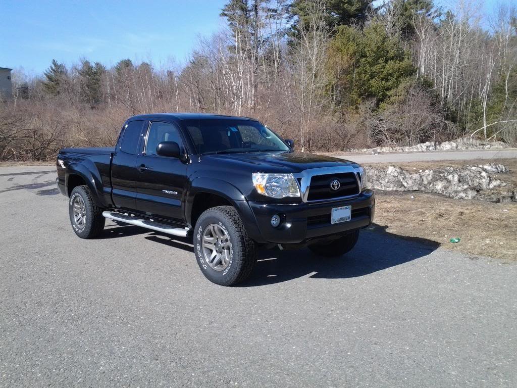

    Toytec sells a lift kit with everything you need like this^^^^.
    I had it on my access cab. Comes with the rear AAL full set of billies and the Einach coils. Sent the clip at 1.75 and there Ya go. Check out my old build If you want to see pics. If you call them they will put the coils on the shock for you and set it where u want. Would run you about $700 bucks if they do that. (Extra 100 for them to put it together)
    With stock wheels
    With XDs and 265/70/17s

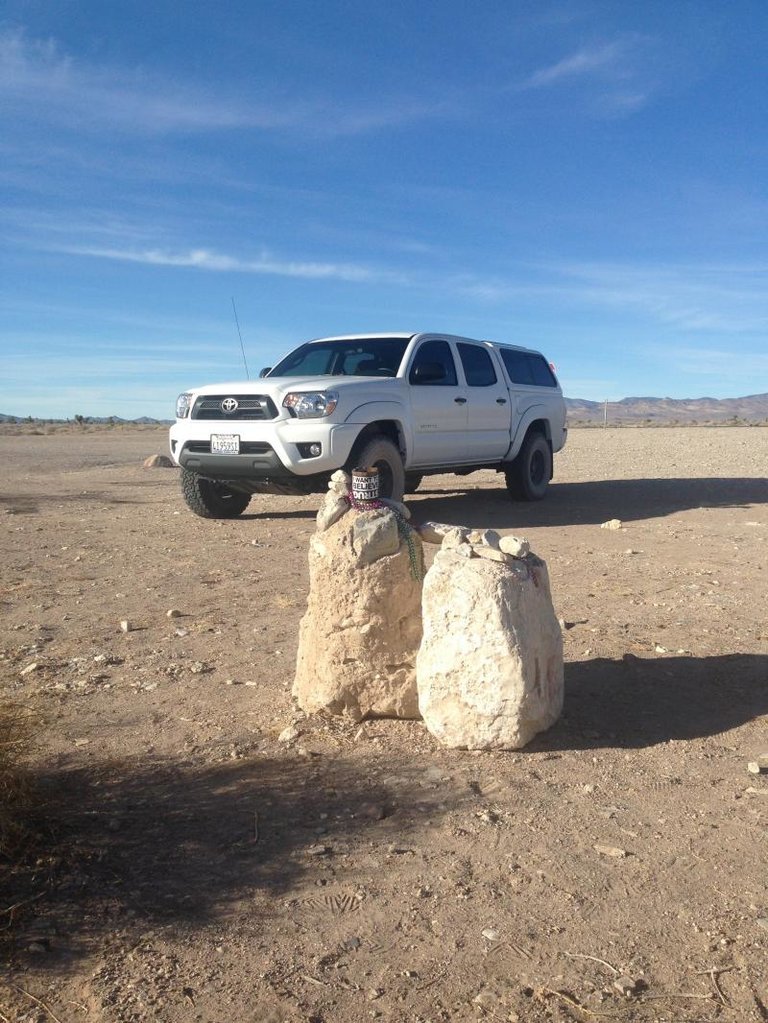

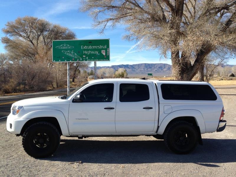

  20. Apr 10, 2015 at 9:46 AM
    #40
    teamcurtis
    teamcurtis Well-Known Member
    Feb 10, 2014
    #122748
    400
    Curtis
    San Diego
    2015 DC 4x4 Super white

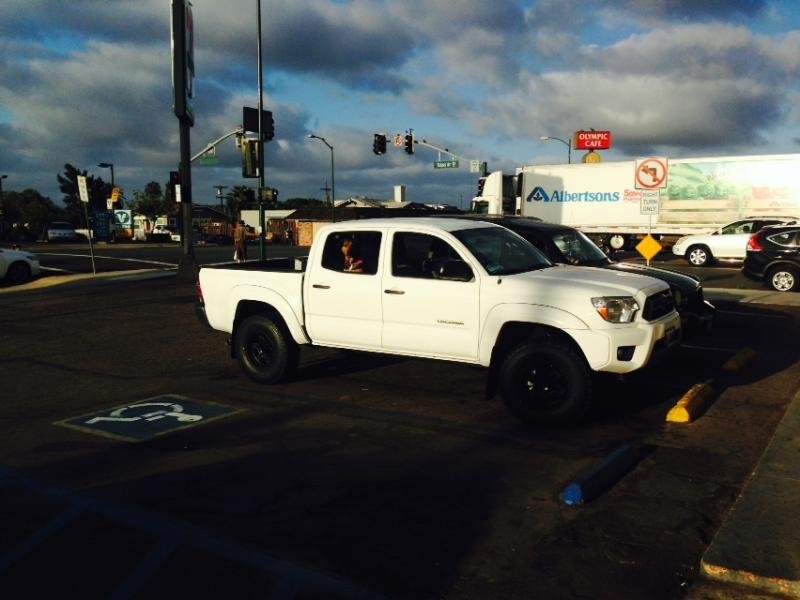

    285/75/16, snugtop xtravision, pop-lock
    5100 at .85 stock rear
    2015 4x NON-trd
    VERY slight rake. I think the next notch up would make it nose high.
    The OME 883 springs would prob be perfect, but more expensive for less than a .25 difference
    The last pic is not on level ground. the nose is NOT high
