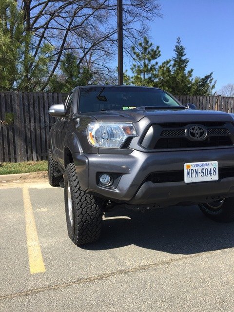

    Thanks! The lift is 5100's all around, front's set at 0 with OME 884 coils, and front lean spacer, rear has Toytec 1.5" AAL. Also installed 1.25" Spidertrax wheel spacers.
    Tires are 265/70/17 General Grabber AT2's.
    I could not be happier.

    Had my truck aligned this weekend. Now I see why people replace their UCAs....

    I mean its not horrendous, but definitely noticeable. The "floating" feeling you get more at highway speeds and the tendency for the truck to jump when you hit a bump. Nothing I can't live with, just noticeable
    I think I just need to find the right shop. The shop I used I trust, but they don't often work on vehicles that have been modified and they were adamant about where they got the numbers. I don't recall what they are off the top of my head, but they were NOT camber = 0, toe = 0. I do know my caster came out to 1.8 on both sides and I know that's not optimal, leading to the floating feeling.
    I need to find a shop that will take the numbers I give them, but I haven't found one in Northern Virginia that will do that. I have a recommended shop from a forum member here, but they are only open weekdays. The time I have is on the weekends.
