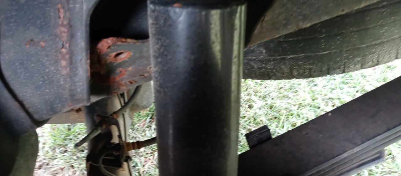

    Crawl under the back and take a picture of shocks and leaf packs.

    Hey guys many thanks. The springs seem stock. I'll try to get a pic for ya asap and post.20220115_121845.jpg

    It's very hard to tell from that photo what you have, but if my eyes aren't lying it looks like you have stock leaf packs with an "add-a-leaf". If you didn't install them I'm guessing the previous owner did. This probably lifted the rear of the truck a small amount like you stated in first post.
    As others have said check your tires and such. Definitely add some weight on rear end if you run with an empty bed. Before I got a camper shell I bought 2x 70lb bags of Sakrete "sand" from Homedepot for like $6 which vastly improved winter handling. Heck with your "add-a-leaf" I'd add 3 or 4 of them bad boys and it will probably ride like an old plush Cadillac.
    Can't tell from the photo what shocks you have. If they are just all black painted with no brands/labels on them they could be anything really, probably something from local parts counter that previous guy installed.
