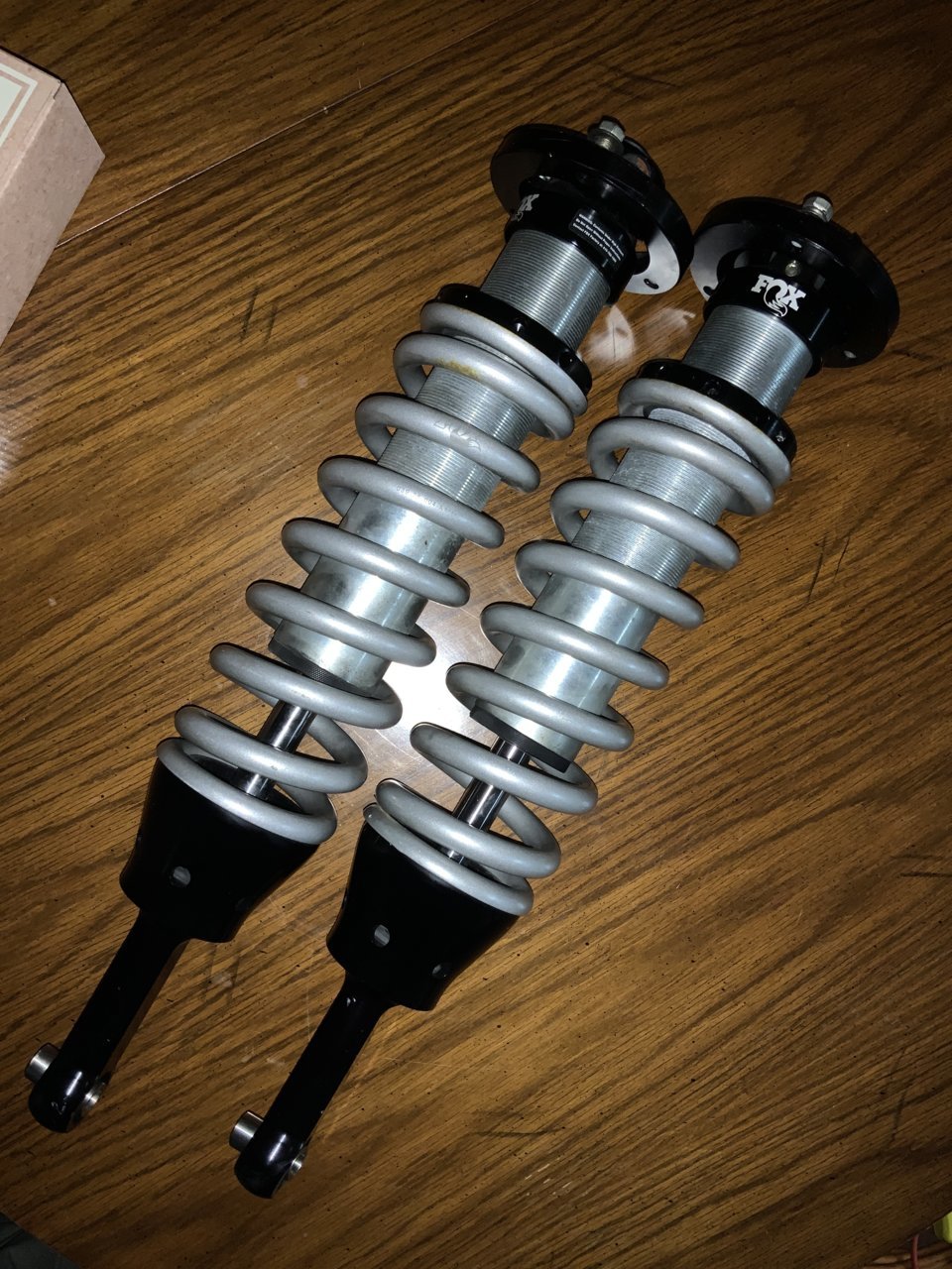

    I just picked up a pair of Fox 2.5 coil overs used. I am so excited! This will be my first big mod. I was able to get the shocks , buts that’s it.
    What else will I need to install these on my stock 18 Sport 4x4
    I would love to hear from someone who has just replaced the shocks if that’s possible at all.
    I’m thinking the fox website says these are direct replacements and no other mods will be needed ? I am broke soo I’d love to not have to get a ton more parts to use these, but would rather have the needed parts before I start the project.
    Thanks!
