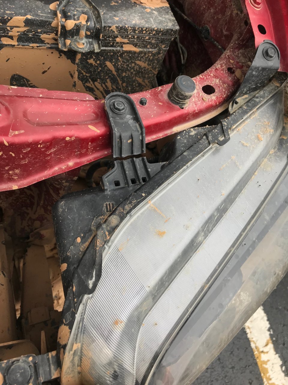

    So I am away at school and won't be home until October, I did some damage to the front bumper off roading. (got real friendly with a tree) Long story short I decided to remove the bumper. The other day I happened to look under the hood and notice that the top pieces connecting the headlights to the frame had started to crack, I assumed it had just happened when I connected with the tree. And then today I looked and one has fully snapped and everything has seemed to sag down a bit so I'm guessing the weight of everything just put to much strain on those pieces and they gave way. Any good fix ideas?

    Probably need a new headlight for that one bud.

    Just gob a bunch of jbweld on there. :thumbsup:

    Or drill some holes in the ridges and wire it together then jbweld it.

    I personally would just JBweld it, especially since it's not something you ever see unless the hood is open.

    My vote is to do both of these together.

    Call your friendly Toyota Dealer just to see what kind of $$ you are looking at. Can't hurt to know.

    ^^ This is your best solution until you can replace the entire headlight.

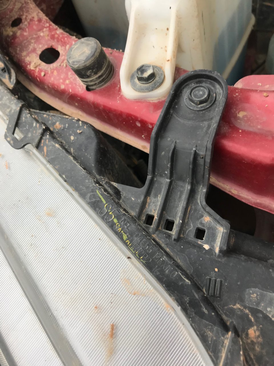

    None of the suggestions will last long as that bracket is obviously under stress, it’s more than just a “hold it in place” kinda tab. Do you have access to a drill / vice & hacksaw? If so, go to Lowe’s / Home Depot, and buy yourself a piece of aluminum flat bar about 1/8” thick and the width of the tap ~1”, simply use the vice to bend it and cut it into the shape of the Z in the tab, drill a hole each end and one in the piece that’s left on the light, and bolt it in. Shouldn’t take more than 15 mins and it will be a permanent fix.

    Remove headlight.
    Drill a small relief hole on the existing, non-through crack. Fill crack and relief hole with epoxy.
    Remove the broken tab and epoxy it back to the original piece. Find (or cut) a few small small piece of aluminum strips, cut & bend them to shape so that they sit flush in the "grooves" of that tab on both the top & bottom of the broken tab, then epoxy both upper and bottom pieces of aluminum to the tab, effectively sandwiching it. Once epoxy cures, drill a small hole through both pieces of aluminum (& the tab sandwiched between) on each side of the original crack, and then put a rivet (or bolt/washer on one side, washer + nylock nut on the other) through each hole.
