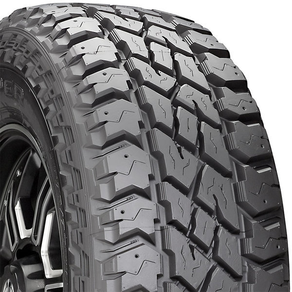

    I back Cooper, run 265/75/16 Cooper ST Maxx and they look beefier than the same size ATP/AT3.

    Not gonna lie, those look incredible! But at $205 a piece, they're a bit outside my price range :( cooper st maxx.jpg
