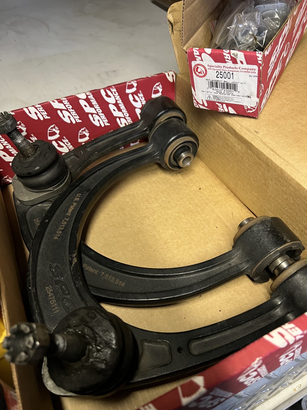

    Well just past 231k mi on my truck . Miles are all me . So I'm finally needing to replace my upper uca and eventually my lca.
    My question for you all is where is a good place to purchase these spc uca online .

    Best place is to purchase them in Mevotech-branded boxes: P/N CMS861197 & CMS861196 (yes Mevotech sells LH and RH arms individually). Quick Googling shows Jeff Bezos has good prices on them. You may find better prices if you take more time to search using the P/Ns:
    https://www.amazon.com/Mevotech-Front-Suspension-Control-CMS861197/dp/B00YWCQABU/
    https://www.amazon.com/Mevotech-Front-Suspension-Control-CMS861196/dp/B00YWCQ95C/
    Beware SPC Xaxis inner pivots don't last that long. If you wheel your truck, they may require yearly replacement. If you want a durable ball joint UCA that's adjustable, AFE and Dobinson have UCAs for about ~$1k.
    If you dont need the adjustability, go with Rancho: https://www.rockauto.com/en/moreinfo.php?pk=7611640&cc=1431544&pt=10401&jsn=487 Inexpensive and uses the same Moog ball joint as everybody else (because Rancho and Moog are the same company).

    Best place to shop spc uppers is in a trash can as that's about what you get. Accutune, dobinsons, dirt king are all better reliable options but they are fixed position.

    Yes they are surplus SPC UCAs, with SPC instruction sheet in the boxes. The ball joint housing has the SPC logo engrave on it. They're as good/as bad as SPCs.
    Prepare to spend twice as much...
    https://www.summitracing.com/parts/afe-460-72t001-g
    https://runnin4tacos.com/products/dobinsons-front-adjustable-billet-uca-toyota-tacoma-2005-2023
    The good thing about this design is you can make adjustments in-situ without unloading the suspension (like you otherwise have to with SPC).

    I have a set on the buy sell trade page on here
    Spc upper control arms with a brand new set of extra ball joints for $450 in so cal.

    Those mevotechs only use the spc ball joint. spc doesn’t use that type of bushing in their uppers either.

    Lol maybe the older versions, and a few bad batches. SPC has been making adjustable control arms since before you were born. They make a great product, and I always recommend them. Custom arms require servicing. Camburg, Total Chaos, dirt king, etc all need new bushings and ball joints at some point. They don't last forever.

    Servicing is fine but there has been far to many sub 10000km failures for me to consider them again. Mine made it 8k before complete failure of x axis and ball joints on bolth sides. Buddies 3rd gen 4 runner same thing. 2 more buddies tacos same failure from primarily street use. All x axis had different batch numbers. My dirt kings are over year with 0 problems no noise just grease once in awhile and go. Sorry but I don't care how long they have been doing it personal experience amongst the group is they belong straight in the trash.
