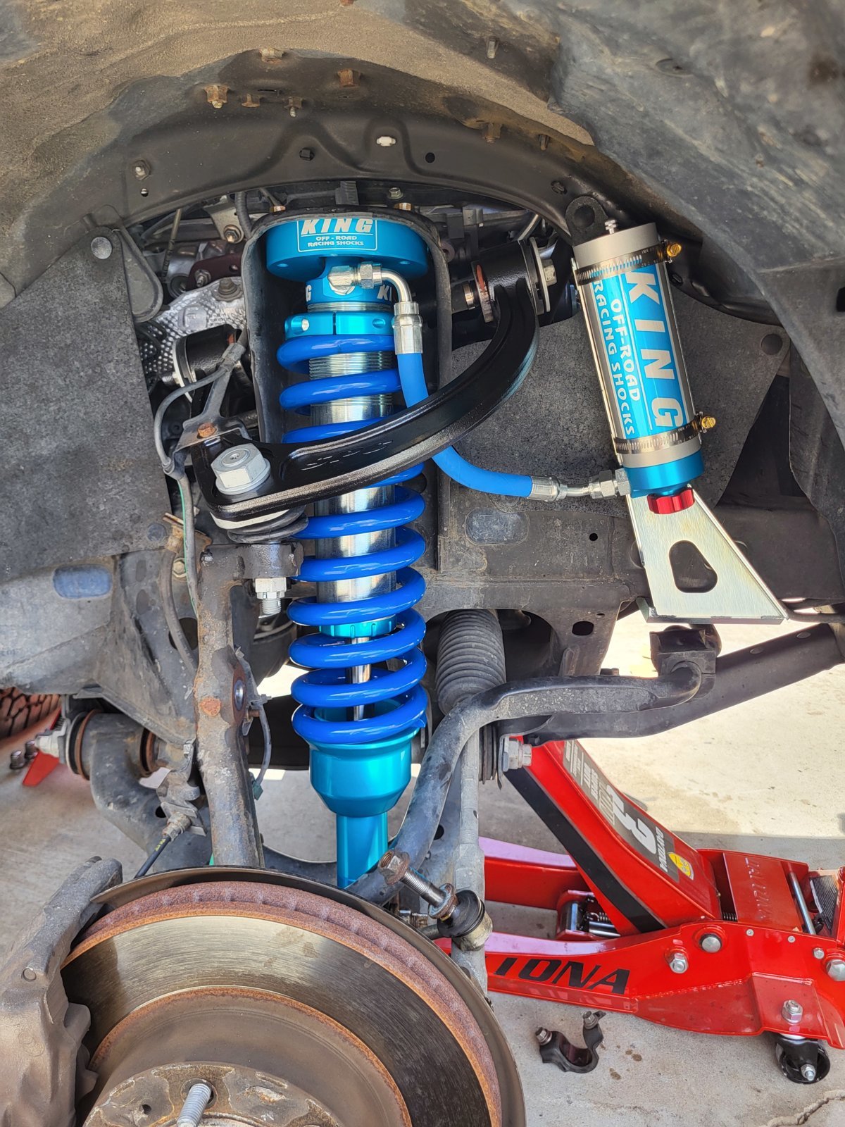

    LX470, 2025 Civic Si
    Installing some SPC as we speak, for a TW member. :D
    shotgunbilly420[OP] and Tcodyw88 like this.
