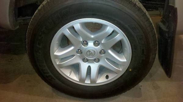

    Forgive my ignorance here, but my '05 TRD off-road came with P265/65R17 tires and rims. First off, I believe my truck came stock with 16" wheels (according to the door sticker), but I'm unsure. I am looking for a set of black, steel winter rims, but pickings are slim (and expensive).
    I think I can use rims from an FJ Cruiser. Am I correct, if so is there a range of model years I should be looking at?
    Thanks in advance.
    ~Jeff

    Most of the Toyota 16" 6 lug OEM rims fit both alloy & steel. There are many pics here of folks running FJ wheels on their tacomas.
    Usually it is a highly sought wheel full black.
    You can also buy a set of steel silver & paint them black or plasti dip them. That is a popular option & the silver are easier to find.
    Also...
    The wheel pic you posted are factory 1GEN Tundra or Sequoia wheels.
    They did not come factory on a Tacoma. I have seen a few with them on. It was a nice looking wheel.
    It was on their non-trd package for sidewall height thus why the Off Road (not sport) come in 16"
    Lastly as a 05 you do not have to worry about the tire pressure monitors!!!!!!!
    Welcome to the forum from Vermont. :wave:
