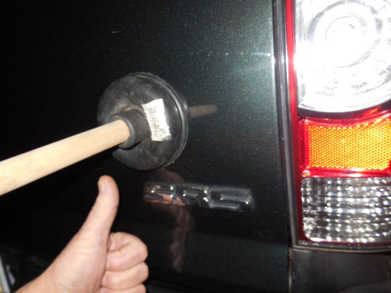

    wash it , then while still wet , use a small version of old type toilet plunger, stick it on - and pull up kinda quik ...pop...
    pic is plunger stuck on....
