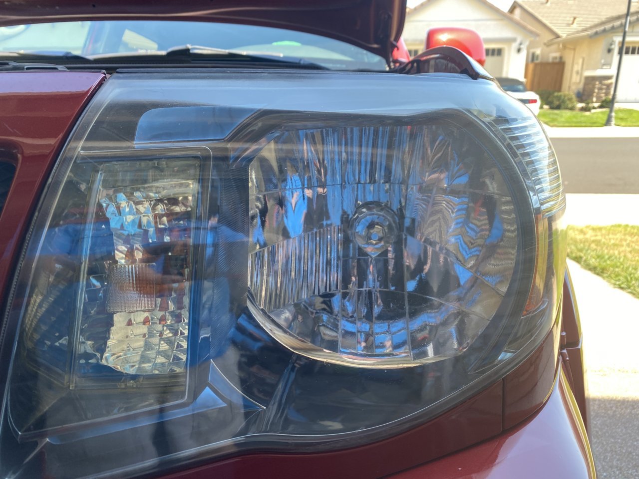

    OP I posted this in another thread on this subject. Here is what I posted -
    Can’t help you as far as new headlights but I can tell you the secrete to making headlights stay crystal clear after restoring them is to put a coat of Headlight UV protectant and sealant on them. When the headlights get hazy and oxidized the UV protectant properties in the plastic have deteriorated. When you refurbish them what little is left is destroyed. There is nothing left to protect them from UV’s and other environmental contaminants, so they get hazy again quickly. Using a protectant will keep them clear for a long long time. I’ve done my lights twice. The last time was a couple years ago and they still look great. I spray protectant on twice a year, easy peasy. My truck is outside 24/7 so no protection from the elements at all. I use Meguiar’s but there are several on the market. Here’s what I use. Also here is a pic of one of my headlights on my 12 year old truck. I polished the lights a little over2 years ago and apply the Meguires twice a year. I originally did the lights around 5 years ago and did them a second time about 2 1/2 years. They really looked good 2 1/2 years ago but I polished them anyway just to make them look even better. The pic of the headlight was taken a few months ago. Looks just as good today.

    Thats exactly what I used....but I cannot seem to get the headlights clear with using the headlights kits they sell to remove oxidation. I used the liquid contained in the kits and buffed with my electric drill for 15 minutes each also using sandpaper that came with the kit but still not looking good. Yours look very good. What product did you use and what was the technique?

    I used Meguiars Heavy Duty Restoration Kit. I just followed the instructions.
