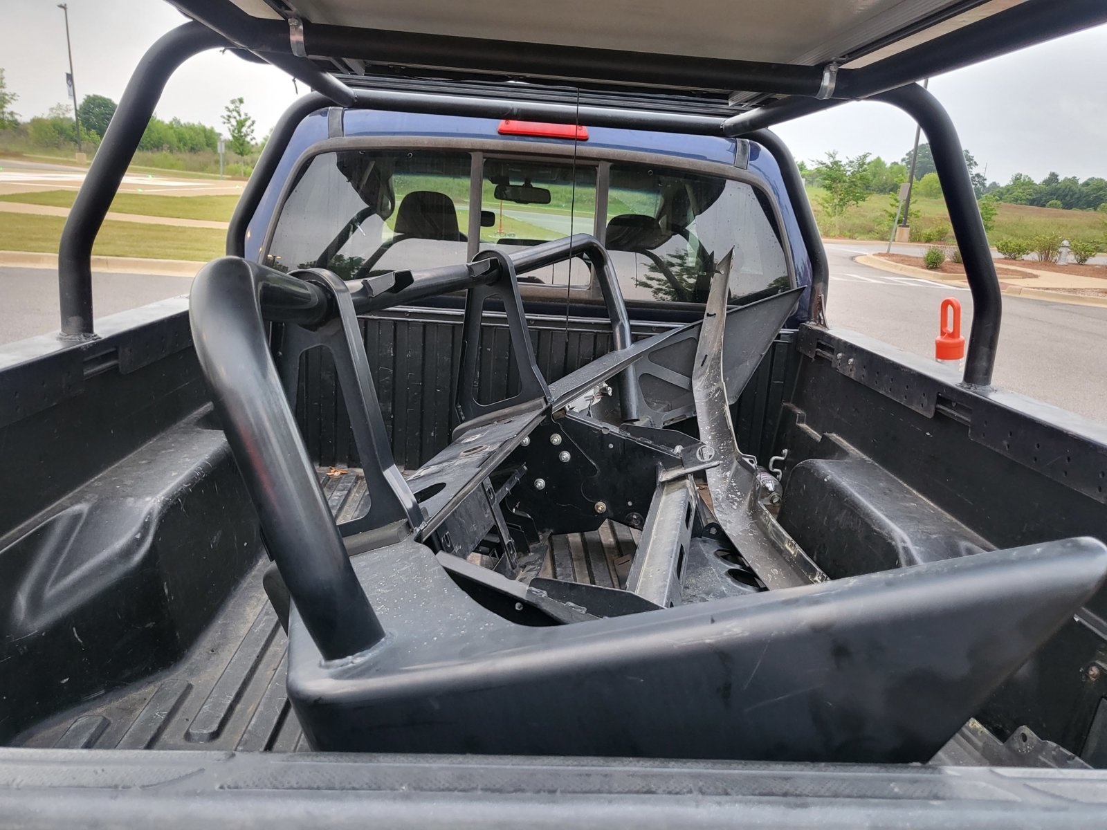

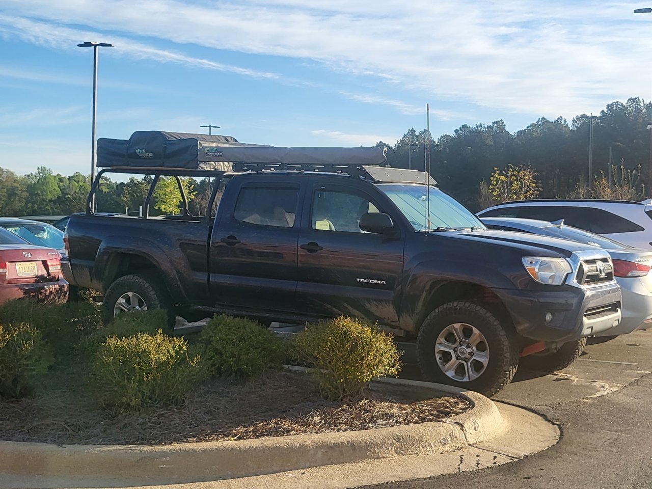

    Look at Dobinsons. I run the adjustable IMS struts and HD leafs. @Crikeymike is great to work with and will get you exactly what you need for the weight you carry.
    How it looks now. Running full SOS skids/sliders, full spare 33x10.5 Kendas
    This will be added at some point
    This was with a decked system and camper shell

    That suspension is slick. I didn't have the need for resi's....so I went with just adjustable. My truck is more of a get to camp over rock crawler. I have absolutely no complaints with it.
    As far as the bike...............I dig those too :D
    My truck was loaded with half a bed of wood, generator, and all kinds of crap :rofl:

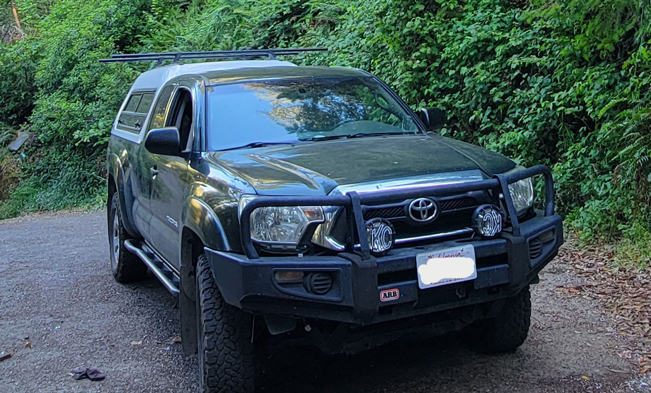

    I used to be into more developed campsites... then I discovered gaia gps. Figured out how to download all of the forest service maps, and sync it with my in dash display... now I look for the most out of the way places I can find.
    The area around bowman lake in the sierras is pretty rough as far as forest roads go, but some of the places we found were pretty amazing.
    I like to fly fish, the girl likes to sit by rivers with a book and a glass of wine...
    We found plenty of room for that and saw very few people. It was great.
    Now that I have those maps, there are many more miles to explore.
    I wish California didn't have issues with extended range gas tanks, but that's a whole other gripe...
