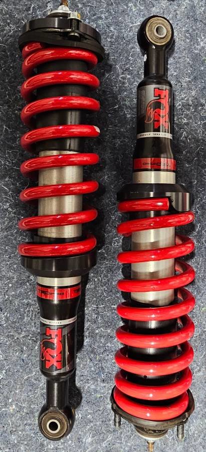

  19. Jun 28, 2025 at 6:09 PM
    #39
    ringchild
    ringchild [OP] Active Member
    Jun 29, 2018
    #257832
    27
    2013 Tacoma trd spruce mica
    these are the fronts, with the westcott lift on them.
    kinda looks like a 1/2in top spacer on there.
    if i removed the top spacer, then i should get an inch less lift, no?
    Well, picking them up in 10min... so no point in worrying now!
    Lol
  20. Jun 28, 2025 at 9:49 PM
    #40
    4x4junkie
    4x4junkie Well-Known Member
    Dec 19, 2018
    #276335
    805
    So Calif. (SFV)
    2018 TRD Sport ACLB MT
    Oh, whoops... That's not the spacer style I was thinking (spacer being between the top-hat and the coil, meaning you would have to disassemble the coil from the shock to install/remove the spacer).
    Yeah those look like common above-top-hat spacers. You can easily get rid of those for sure (looks like one shock already has it missing anyway).
    ½" = 1" lift is correct. (it's actually closer to 1.9:1 ratio, so... yeah)
    ringchild[QUOTED][OP] likes this.
