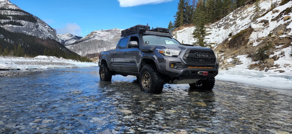

    0 offset wheel with a 265/70r17 or 265/75r16 replace mudflaps with rokblokz 99% of the time 0 rubbing and all the looks with none of the cons of lifting. Keep it simple till your suspension is dead research a ton till then.
    When shopping around for wheels always check the weight there's a ton of popular wheels and tires on here that are complete boat anchors and will hinder your ride quality rather than improve.
    I also say if this truck is a daily keep the lift 1" or less don't level don't go over a skinny 33" tire and you will appreciate it far more.
    I have a fairly thorough build and I love the truck but I only drive it on weekends. If it were a daily i would revise my set up.
    17x9 0 fuel kicker 6
    265/70r17 duratrac
    All stock sport suspension
    285/70r17 duratrac
    Elka 2.0 ome med leaf pack spc uca 3" front 2"ish rear
    carrier bearing spacers and front clamshell bushing installed ov tune
    17x9 -25 summit apex
    295/70r17 G003
    Elka 2.0 ome med leaf pack dirt king uca
    2.5" front 2"ish rear "i started to really see my leaf pack flatten at this point"
    Cmc pinchweld fold and fenderliner trim required,
    17x9 -38 falcon t8
    295/70r17 G003
    Elka 2.5 dsc fronts 2.5 rear dobinsons 112 leaf pack
    2" front true 2" rear lift when loaded
    Cmc pinchweld fold, front fender liner tuck, angled leaf shims, u bolt flip kit waiting on the tire to self clearence the fender flares when ever it's stuffed.
