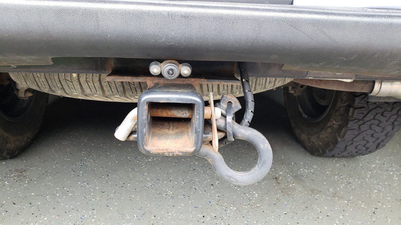

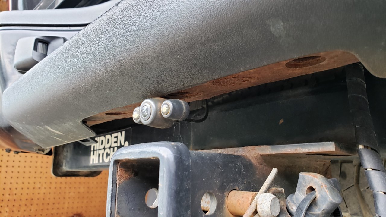

    Something to keep in mind, I added a back up camera and initially wanted it in the handle, but that meant anytime the tail gate was down its useless. I ended up fabbing a bracket to go above the hitch that ended up working a lot better for me.

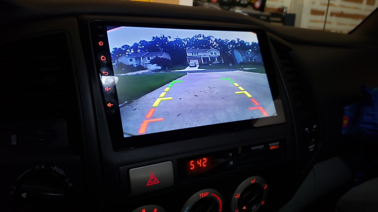

    I actually used a camera that had a bracket already installed so I just screwed it into the bottom of the bumper as shown. The head unit shows the picture with the tailgate down so I can use it if I have a load longer than the bed which you couldn't do if it was handle mounted. This also made wiring a lot easier not having to route it through the tailgate. I used one similar to this one :

    nice. can you see and align the hitch with this view?

    Yep, lines up really well with the top of the ball. Depth is difficult but I don't tow a whole lot
