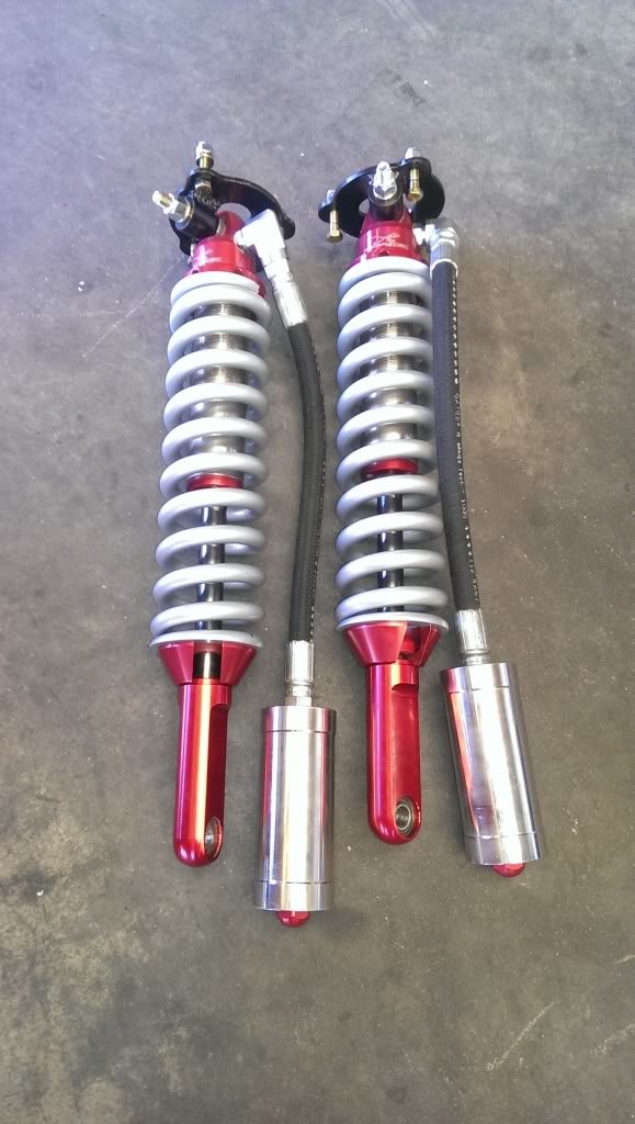

    What exactly is minor to you? You do realize that minor is the gateway to heavy wheeling right? Lmao. That is how it ended up working out for me, and I couldn't be happier with the choices I made at this juncture. So much so that any other brand truck feels like crap driving it. If you or even the OP does 5100 fronts, you will be left with a lot to desire and wish you had went the coilover route from the get go. I speak from my own experience and mistakes. :)
    These are conversions that I built, never meant to fit OE, but anything short of these kind of shocks, I would regret having.

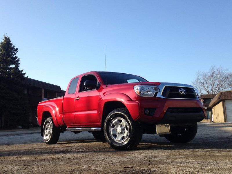

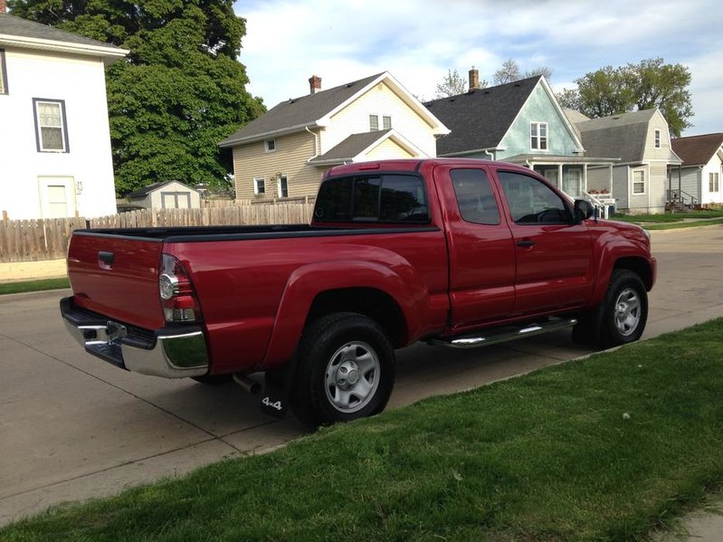

    As she currently sits
