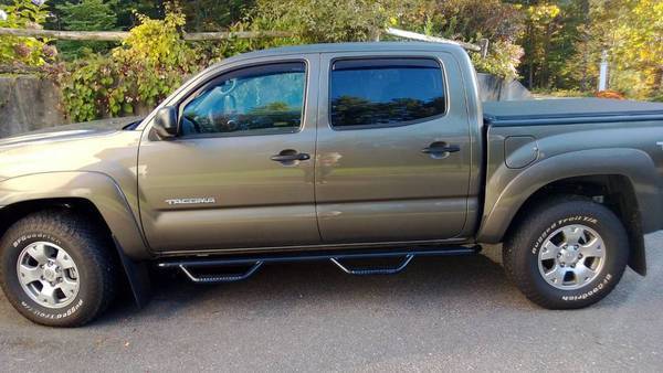

    Any chance you have a before and after of your truck with the lift on it? How was the install?

    Before
    After: also diff wheels and slightly larger tires
    I had the install done. It was about a day and a half including alignment and tire swap. I've had no problems with the light racing ucas, but if I were doing it again I would pay extra for a fancier / stronger uca.

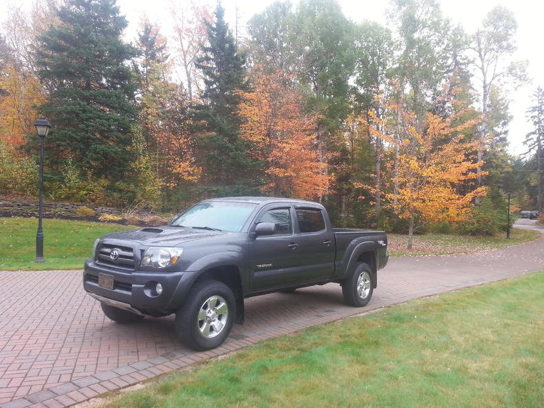

    I Just installed the bilstein 5100 adjustable shocks with the toytec coils and diff drop last week. Got 2.5 of front lift, and 1.5 rear block, very happy with it drives excellent, no vibrations at all and the truck drives nice and straight. Also still using the stock UCA's and no problem getting it aligned, highly recommend.
