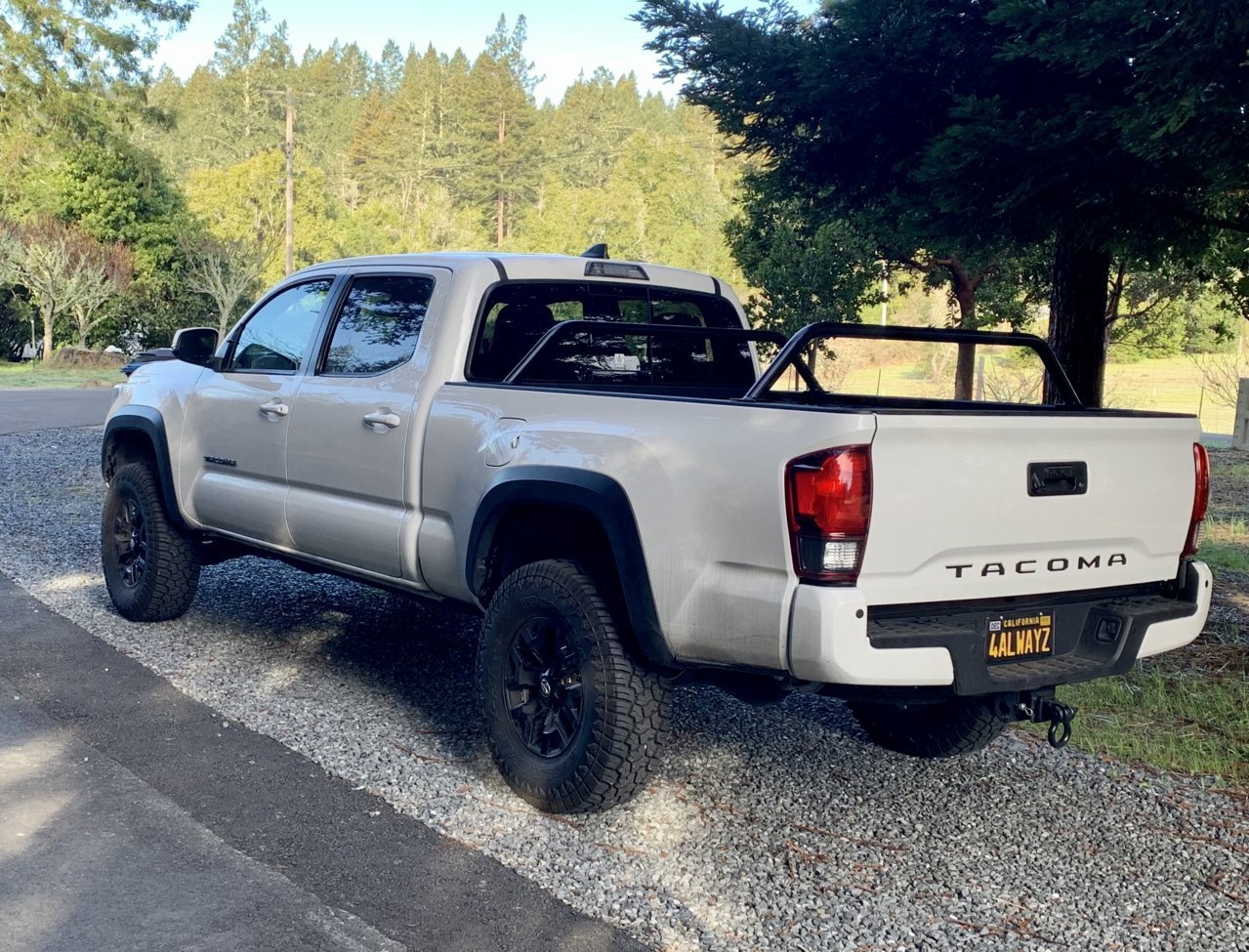

    Pic for the hell of it.

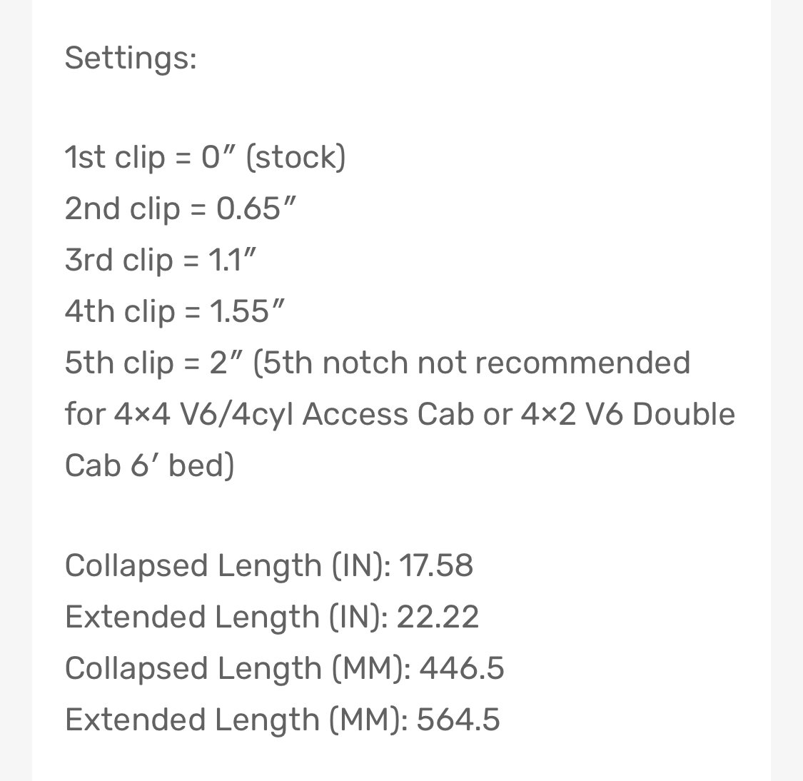

    5100’s 4th setting. 1.5” front lift factory coils. 1.5”rear lift. Maintained factory rake. Ride is great. Imo great lift for the price. Camping and light off-roading etc. Good luck. 6112 are a sick set up as well

    4th setting is fine for factory coils.I did not max out preload. Ride is nice. Imo. Rear 1.5” aal is great maintains factory rake. Or you can get a leaf pack. What ever you guys go with will be great. My ride is perfect with factory coils. I’ve also seen a thread on here that Bilsteins don’t warranty 5100’s with after market springs. 5100’s are direct replacement meant to be used with stock coils.

    My dad really likes his with 5100’s with stock springs at the middle notch and it have him about 1.5-2 inch lift. He said the shop did some alignment but didn’t have to mess with an add a leaf.
